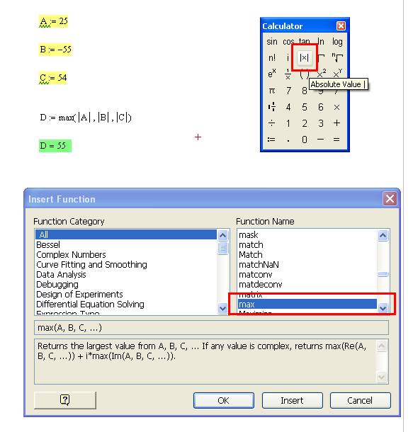

Best answer by VladimirN
You need to use "Absolute Value" operator:

Does this help?

My situation is:
I have these values o results
A:= 25
B:=-55
C:=54
I need to extratc the maximum absolute value from (A,B and C), in this case is 55
March 3, 2013
Doesn't "max(max(A,B,C),-min(A,B,C))=" work??
It should.
