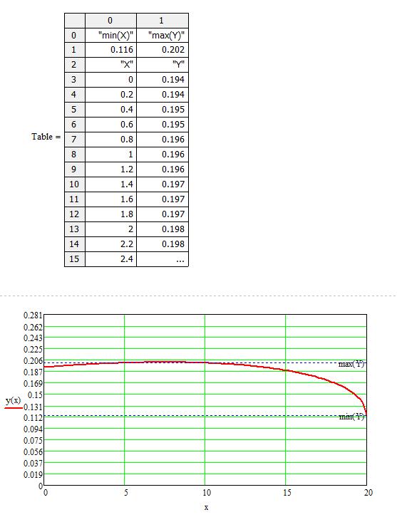

One variant of the ymax.pngsolution your problem:

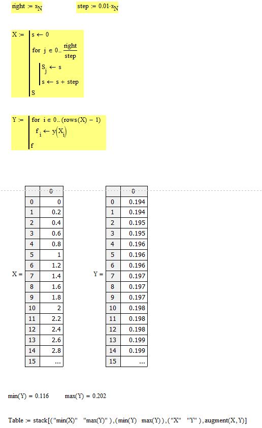

Hello!
I have added your file with a new program code for transformation (X and Y(X)) in matrixes. Now you can normally work with them further: to calculate a maximum and a minimum etc.
