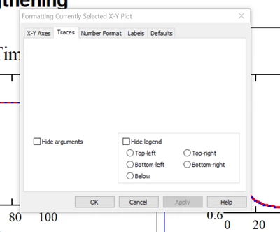

I am still using MC 14.0. I had to re-install it because the motherboard on my computer went bad. Now, when I go to the Trace tab in plot format it comes up blank and clicking on anything but cancel crashes the program. Other tabs are fine. I installed the M020 release but that did not help.

Thanks to all who offered suggestions. The (or, at leas, a) solution turned out to be incredibly simple. When my computer guy tried to install M020, he unpacked the files to a location that was different from the default. M020 then installed without difficulty and for reasons that he did not know (and I certainly do not) that solved all the problems.
