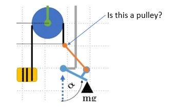

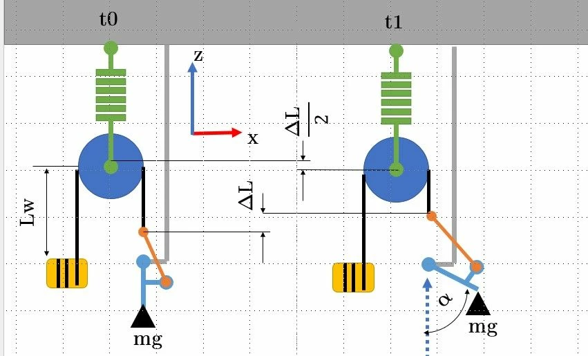

I have a mechanical problem, but i don't a have a mathematical skill to solve it, I hope that someone could help me👃
in first, see simplified drawing:
     in yellow box , is a winch
  2.  wire betwen winch and pulley (steel cable,the length is low, the elongation can be a constant, maybe )
  3. pulley connected to ground with spring
  4. wire betwen mechanical elbow and pulley (steel cable,the length is high, i need to use Hooke's law for evaluate elongation, and correct this to calculate good Lw parameter)
  5. mechanical elbow
  6. mechanical load mg ( for simplify what happens in mechanicel elbow, we consider un traction forces on wire node at elbow)
At t0 system at rest  : it is as if the spring is a bar
At t1, the winch pulls to make an ordered value for alpha
Find Lw according to alpha angle, the object of the game is that the winch gives a Lw length which allows to maintain alpha angle according to the instructions (angle ordered)
What i feel : variable is a function f(x)=k(x) , here is a differential equation
I do not know, neither to pose this problem nor to solve it😓
this is above my skills, but it's very interesting
Anyone can help me ? I would like to learn how to solve this

i can add this comment:
At t0 we have a small load in wire. (prestressing)
This small load it make by traction spring, and it is nessary to avoid the cable goes out of the winch
Of course the winch is connected to a motor, and motor is connected to ground
the speed is low, and the system has time to equilibrate, it can be considered static I think
XDN14-AlexandriteAuthor
November 26, 2021
Another one things, for show the scale, the wire cable diameter is 1 millimeter
and the systeme is small, the pulley (made with steel)  diameter is 40mm and this  thickness is 4 milimeter
I think that we can neglect the masses and the inertia of different part.

Need one more clarification:
What is the force reaction at this point?
November 26, 2021
This point is not a pulley, is a hinge
and this hinge had a linear guidance on z_axis with ground
in the same way, the pulley (blue circle) have a linear guidance on z_axis with ground
i calculated reaction forces at this point in terms of alpha angle (resulting moment theorem)
and i finally, i find the lenght cable for alpha angle value 0° to 90°, it's no linear.
i translate my worksheet, after this, post it .
23-Emerald I
November 26, 2021
If that hinge is constrained in x, then the tension in the cable is constant equal to the weight m g.
