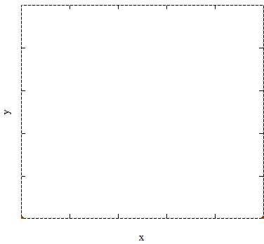

You can see in attach a Mathcad 15 file with solution of this problem.
But I think that will be better to use not a X-Y system but a Polar system of coordinate - for the calculation and for the plotting - not only for 4 animals but for 3, 5, 6 etc. Help me please!

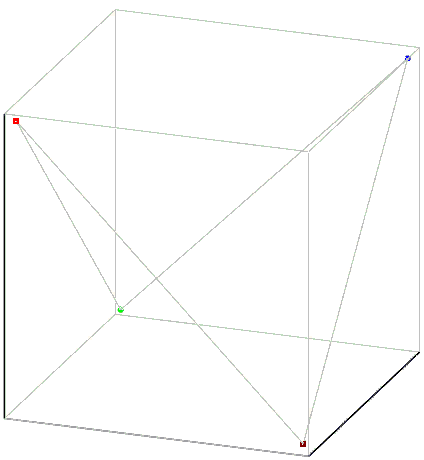

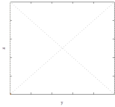

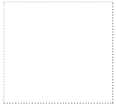

3D variant - not mice but bats!
October 14, 2018
3D animation without three 2D animations is not an animation!
November 27, 2018
Sorry - it is not bats but bugs problem! But for me bugs are not 3D but 2D animals!
