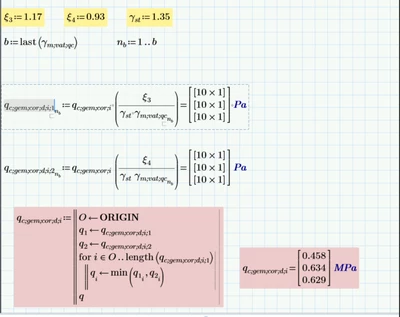

Just one question about ( min function) why it works only with scalars ... whenever I want to use it with vectors or matrics  it doesn't work ...
How to overcome this ?
Should I always use programming ?
For example the following program : in each (qc;gem;cor ) I have 3 matrics each one has ten values.... what I need is to write a program that will compare the both variables and choose the minimum value of each one ( compare the first raw with the first raw  and chooses the min ...and so on  ) ...and the result should be also one matric with ten values. However, it chooses only the minimum value of each matrics

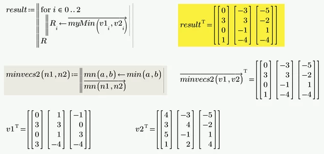

It seems to me that @YA_10963798  would need you function but for only two inputs.
Applied to the simpler example posted in the other thread this would mean
BTW, I seem not to grasp the necessity of your local function minv?
Prime 9 sheet attached.

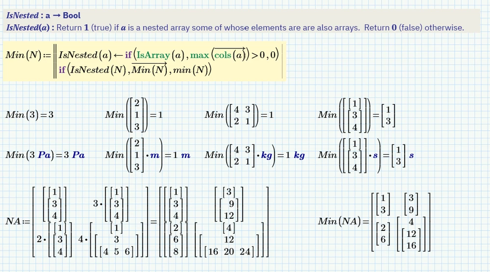

Try something like the function Min shown below.  It recursively calculates the minimum of each nested array ... well, it's supposed to!
The last one is messy but interesting.
Stuart

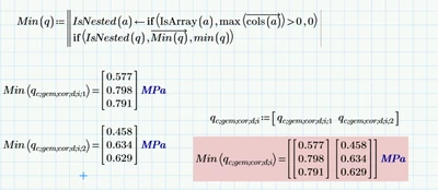

Hi Stuart,
I tried it
Actually what I need is something different I need the program to compare qc;gem;1 and qc;gem;2 and choose the minimum between both of them.
So , it goes to the first raw in both variables and choose the min and then goes to the second one and does the same.
but what we did is just choose the min value in each matric
