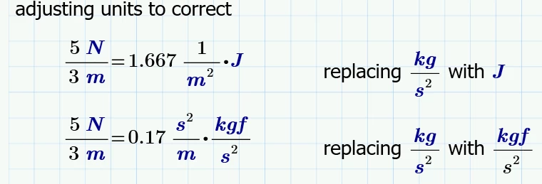

You don’t need to divide the result by the desired unit (N/m), but you can multiply the displayed unit ( kg/s² ) with the desired unit (N/m), to make  kg/s²  disappear. But you'd have to do that for every result.
Custom units are possible since Prime 11, but it's not the holy grail, apparently.
I Assume, in your example, you have chosen SI as the base for your custom units. Then it's a shame (or rather crime!) that you only can choose non-SI units to choose from for force per length.
Consider submitting this as a severe bug.
Note that kpi, klf and plf are (defined as) ‘single’ units, which may be a limitation for the Custom units functionality. You can define N/m as a ‘single’ unit as well using:
See if this allows you to choose it as a custom unit for the force per length dimension.

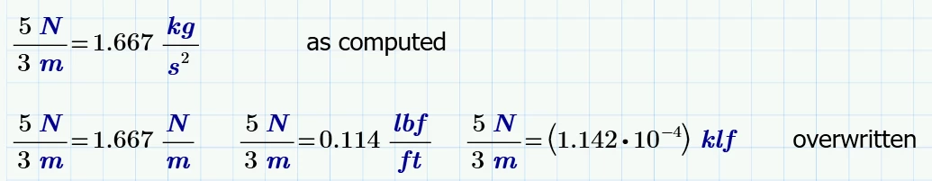

23-Emerald I
May 17, 2026 12:44 PM UTC
I can see how that is frustrating.
You can however simply select the units Prime writes and simply overwrite with the units you would like.
This also provides one of my favorite error checking features.  Mathcad will force units to balance; if you expected the answer to be a particular unit and Mathcad adjusts by adding additional units then it’s time to decide where the discrepancy is
