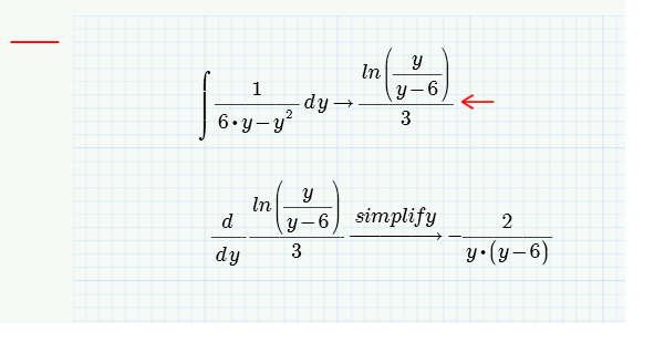

A student asked mathcad to supply an antiderivative. Not quite believing the answer, she factored the integrand and tried again and recieved a different (this time correct) answer.
I've attached the file which shows the incorrect antiderivative and a line in which I differentiate the incorrect antiderivative and do not arrive at the original function.

Yup, it's a bug.

Yup, it's a bug.
March 8, 2012
If you haven't already checked by hand, the denominator should be a 6, not a 3.
March 9, 2012
Hand? No, I checked using the old Maple engine in Mathcad 13. With a reliable symbolic processor one doesn't need to check it by hand.
March 9, 2012
Strangely, just changing the denominator to (6-y)y produces the right answer!
Alan
March 9, 2012
My guess is that a programmer incorrectly typed in the formula for int( 1/ ( variable^2 - a * variable) dvariable) and that incorrect formula is being used.
Yet, if you factor it, it prompts the program to try integration by parts.
Mathcad does do the partial fractions on the fraction if you ask it to.

Same Bug in Prime 2.0
March 12, 2012
The result in Mathcad Prime 2.0:
March 12, 2012
I logged the bug to be fixed in the next release.
