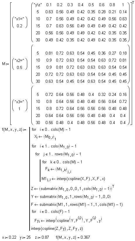

One interpolation of data in 3-D array:

In many programming languages​​, there are language extensions that simulate queries (JavaScript - jQuery, c# - Linq).
You can hide work with multidimensional arrays, using a set of special functions. Like this: Linq - useful functions for working with sets.
