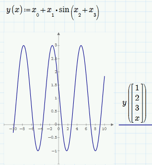

What I understood from your writing was that you are trying to so something like the attached. It works, but sometimes you have to change the labels of the variables (from variable to none or vice versa) - this is a very annyoing thing in Prime!

One other way:

Nice.
Its a shame we cannot plot family of curves as in Mathcad 15 and below - at least not the easy way. We would have to create matrices to plot via waterfallplot (which at least will be default for matrices in Prime3). Any chances we get the easy way back?
BTW, what screen capture program are you using? Why is it that ibn your pic we see the single characters the brackets and parentheses are consisting of? Or is this the new to come copy/paste feature of Prime 3ß ? Using a capture prog I get the following:
