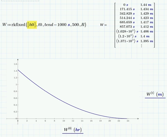

3,  I also solved the IVP with rkfixed.  The units came out incorrectly.  The dependent variable column of the output was labeled m*s instead of m.

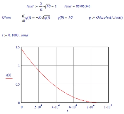

In (real) Mathcad 11 the odesolve runs just fine:
I've checked Prime 7 and 8, they both quit at (about):
where
I have no clue as to why.
Maybe someone with Prime 9 can check....

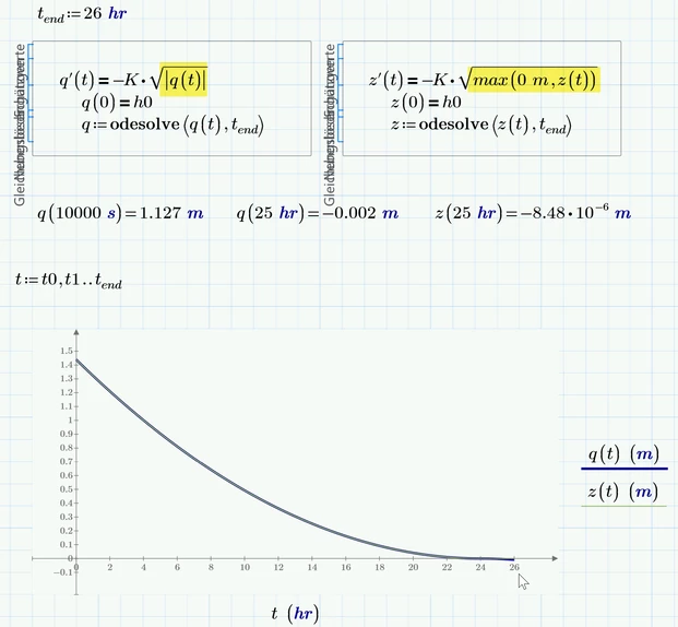

I am not sure but the OdeSolve() block seems to fail because of numerical round-offs / inaccuracies. It looks like the numerical value of z (or q) is getting negative and so its the root which actually throws this error.
You may consider one of the two workarounds you can see in the picture:

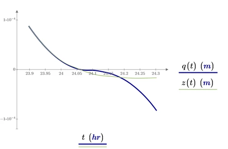

The differences can be seen in the next pic and I guess its in a region which is not of interest to you anyway
In the workaround the "max" function could also be replaced by q*(t)=-K*Re(sqrt(q(t)) with the same effect.
The wrong unit returned by rkfixed is strange.
According to the help (the example there) the initial value should be a vector (a 1x1 vector in your case).
Providing this 1x1  vector instead of a simple scalar cures the wrong units problem (have no idea as to why it does, though).
The same example in the help
-> Example: Solving a First-Order ODE Initial Value Problem
also treats the second argument of the vector function as a vector even in case of a single function first order ODE
But this seems not to matter as your sheet is working both ways
