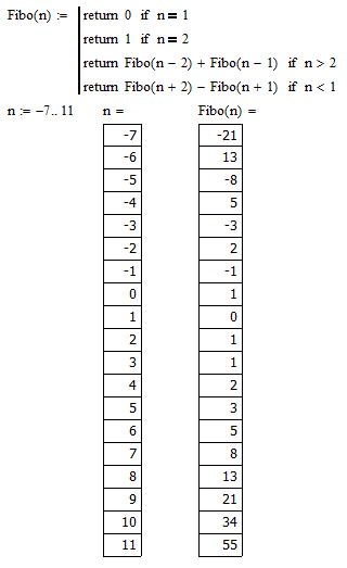

Do you know fine Fibonacci Numbers:
http://twt.mpei.ac.ru/ochkov/mc8Pro.book/6_text.files/6_12.jpg
