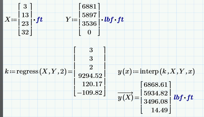

It is one problem for Mathcad Prime!

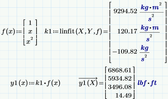

But I think 3 last coefficients of the vector k must be (better) with units:
k is correct with units with the linfit function:

Oh yes, I forgot that we can see the coefficients with regress, too.
Your pic shows that Prime does a bit better with units than MC15 but isn't perfect. I agree that the output of regress should include units. And unfortunately we can not change the units of the elements in a vector with mixed units singly (which would be nice for your k1) as the placeholder is after the vector or matrix and will affect all the elements. Hopefully this will be fixed in Prime3!?
Don't know if Leopoldo has access to Prime so I include your suggestions (getting the coefficients with regress and using linfit as yet another method) in the attached MC15 file. We could use genfit, too, but enough is enough, I think.
