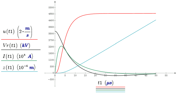

Ok guys this is what I am trying but I don't know if I going about it the right way...
March 27, 2012
Looks to be a good starting point.
2 minor problems with the sheet that I have noticed.
1. the number of intervals is set at 2 so the ODE doesn't give an accurate output, I've changed that to 2000 but you could leave the parqameter out it will default to 1000,
2. the ODE now gives a very fast response & I guess that this will be correct. So I have modified the end time to 20us so the graphs are showing the overall curves.
Whether the result is representative or not, I can't say.
Hope it helps
regards
Andy
