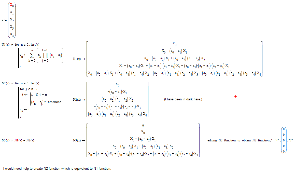

Hello All,
My question is :
Thanks in advance for your time and help.
Best Regards.

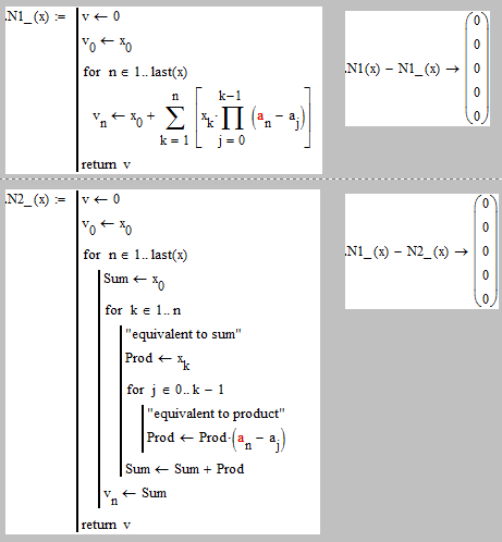

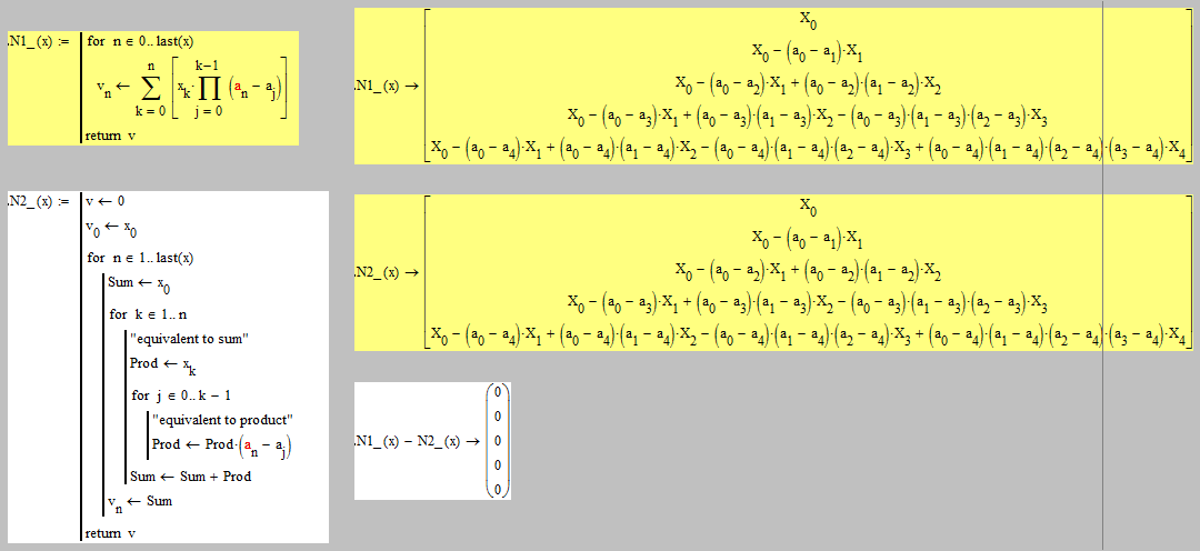

Best answer by Werner_E
Find attached the modified progs for N1 and N2.
I still have no clue what the benefit of avoidubg sum and product should be!?

You've only defined the product loop - I can't see where you've defined the summation equivalent?
January 20, 2013
In your definition of N1 the product runs from 0 to k-1 and is inside the summation with index k starting at 0. That way you would address vector element -1 which does not exist (assuming ORIGIN=0). This is to be avoided as summation and product react somewhat illogical in that situation.
Does N1 give you the desired result? Even then you should rewrite it.
You can easily rewrite your function N1 withou using sum and product using three nested for-loops for n, k and j, while I can see no reason why you should want to do so! The new function will produce different results because auf that failure above (you will get expressions with (a[-1.
Werner_E25-Diamond IAnswer
January 20, 2013
