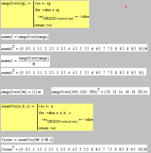

I have a range, but I need to turn it into a vector in order to be able to work with is. Can this be done? I have attached a sheet with an example.
Best answer by RichardJ
There are several versons of this function floating around. This is my preferred version.
RichardJ19-TanzaniteAnswer
July 11, 2013
July 11, 2013
July 11, 2013
Here are some similar routines to turn a range into a vector or to create a vector on the fly by given first, second and last value for your convenience.
