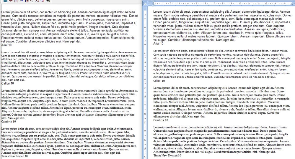

Mathcad is on the left, MsWord is on the right.
This is how it shows in the application:

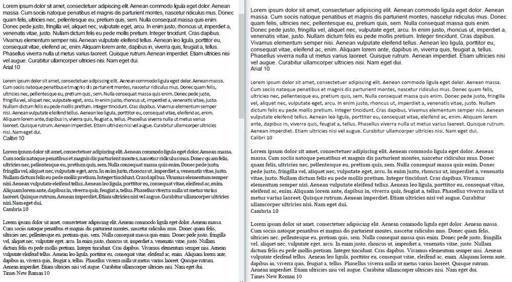

And this is what printing to .PDF gives:
This .pdf was generated with 'Microsoft print to pdf', but printing to a .ps file and subsequently distilling the .ps to .pdf produces essentially the same result.
Note that you can choose your fonts; in Mathcad it's a little more versatile than in Prime. You might consider going for a 'wide' font...
