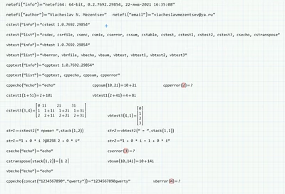

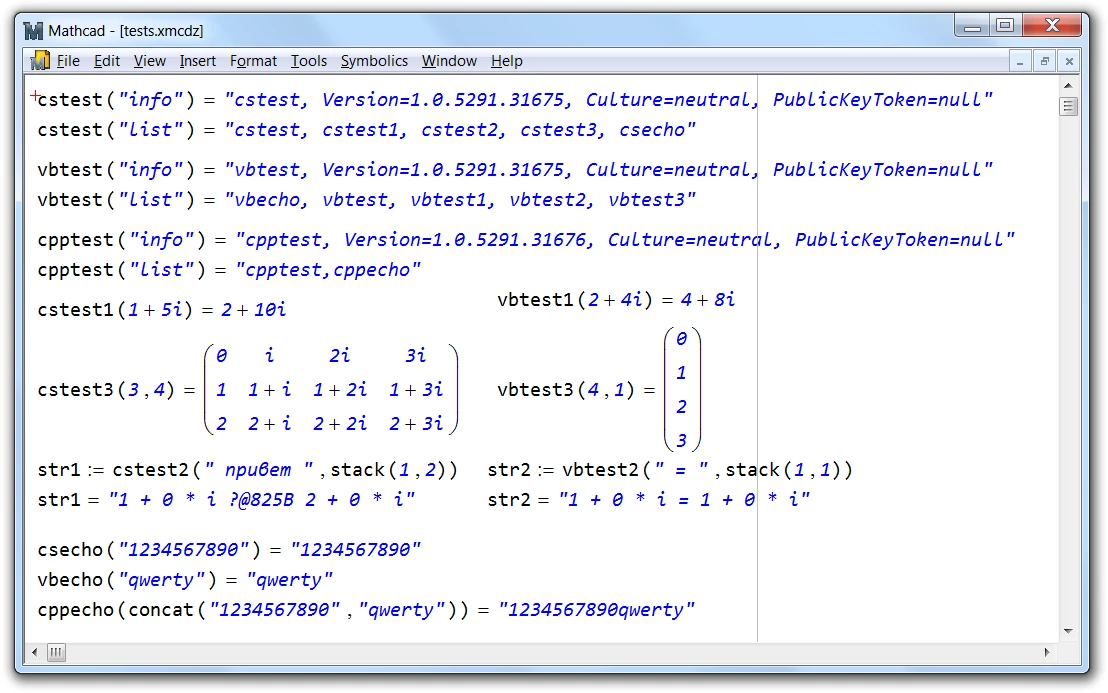

Updated.

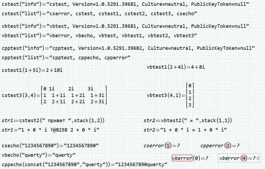

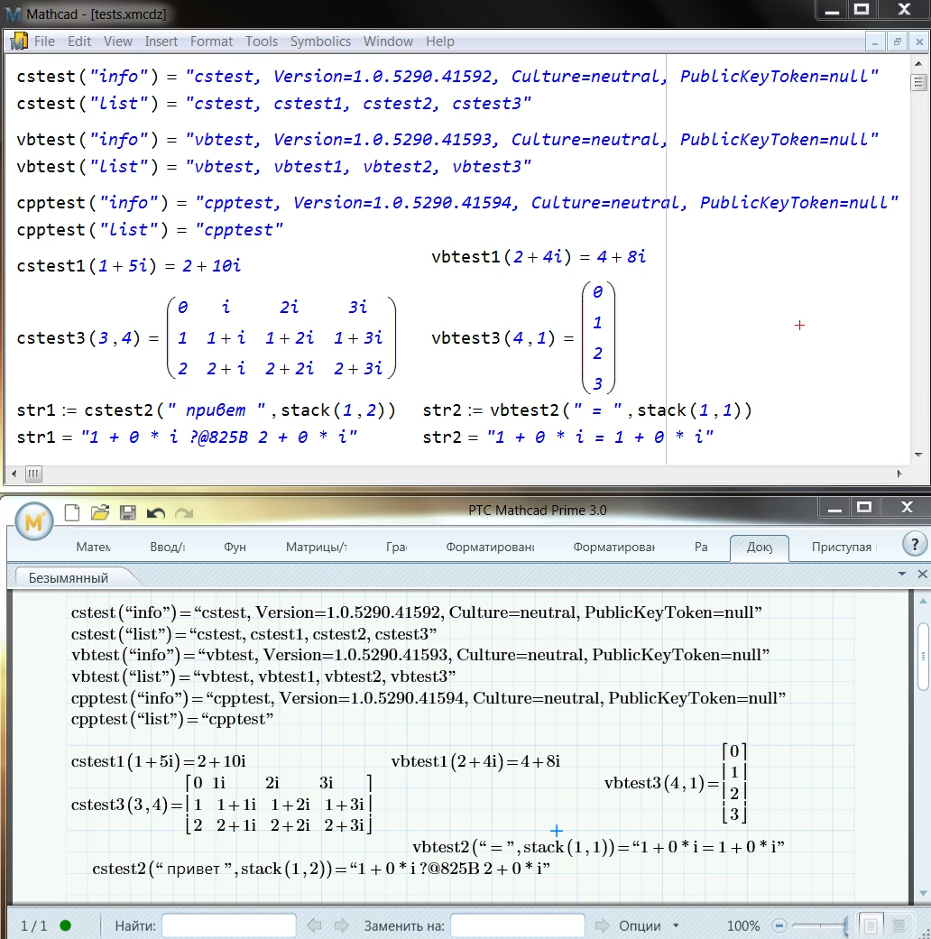

Now 3 test projects available: c#, vb.net and c++/cli. All based on .net 2.0.
July 7, 2024
Mathcad Prime 10.0 x64 also supported.
June 27, 2014
Updated.
- echo functions added;
- small changes.
Simple examples are attached (pdf files).

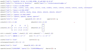

Updated.
- error handling added (only one function in the assembly may contain a static field Errors - array of strings).
For example:
using System;
public partial class cserror {
public static String[] Errors = {
"cserror 1",
"cserror 2",
"cserror 3",
"cserror 4"
How to use:
using System;
using NetEFI;
public partial class cserror: IFunction {
public FunctionInfo Info {
get {
return new FunctionInfo( "cserror", "n", "return error string",
typeof( String ), new[] { typeof( TComplex ) } );
public FunctionInfo GetFunctionInfo( string lang ) { return Info; }
public bool NumericEvaluation( object[] args, out object result ) {
throw new EFIException( ( int ) ( ( TComplex ) args[0] ).Real, 1 );
EFIException( ErrNum, ArgNum) - like in MAKELRESULT().

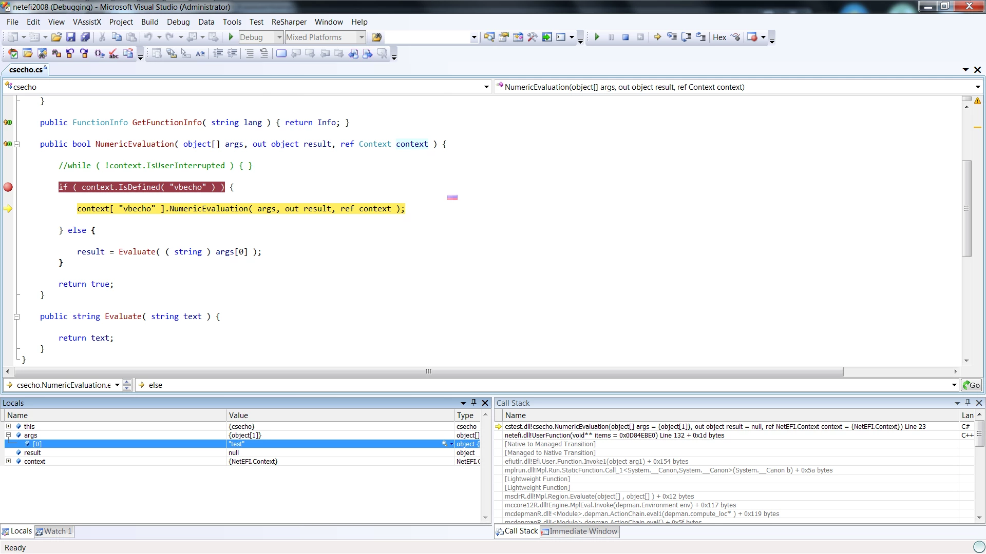

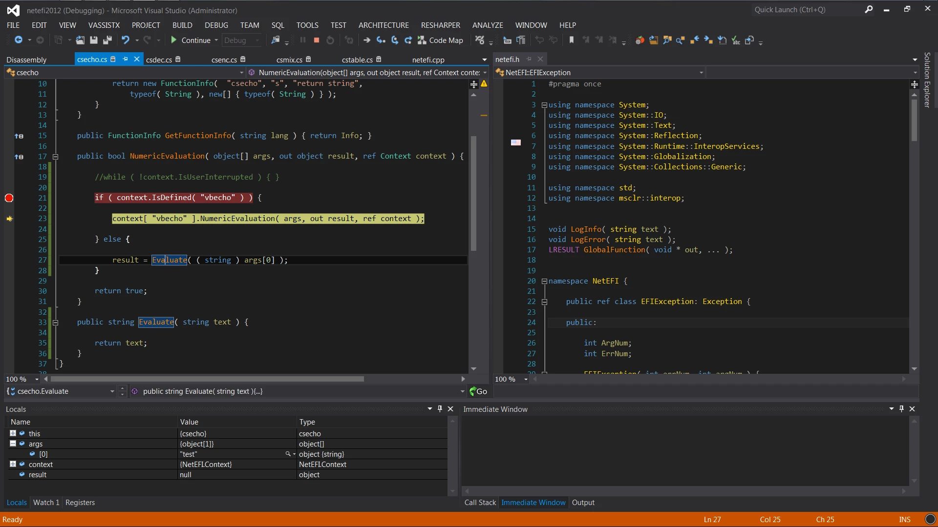

Now you can use context:
public bool NumericEvaluation( object[] args, out object result, ref Context context ) {
//while ( !context.IsUserInterrupted ) { }
if ( context.IsDefined( "vbecho" ) ) {
context[ "vbecho" ].NumericEvaluation( args, out result, ref context );
} else {
result = Evaluate( ( string ) args[0] );
return true;
public string Evaluate( string text ) {
return text;

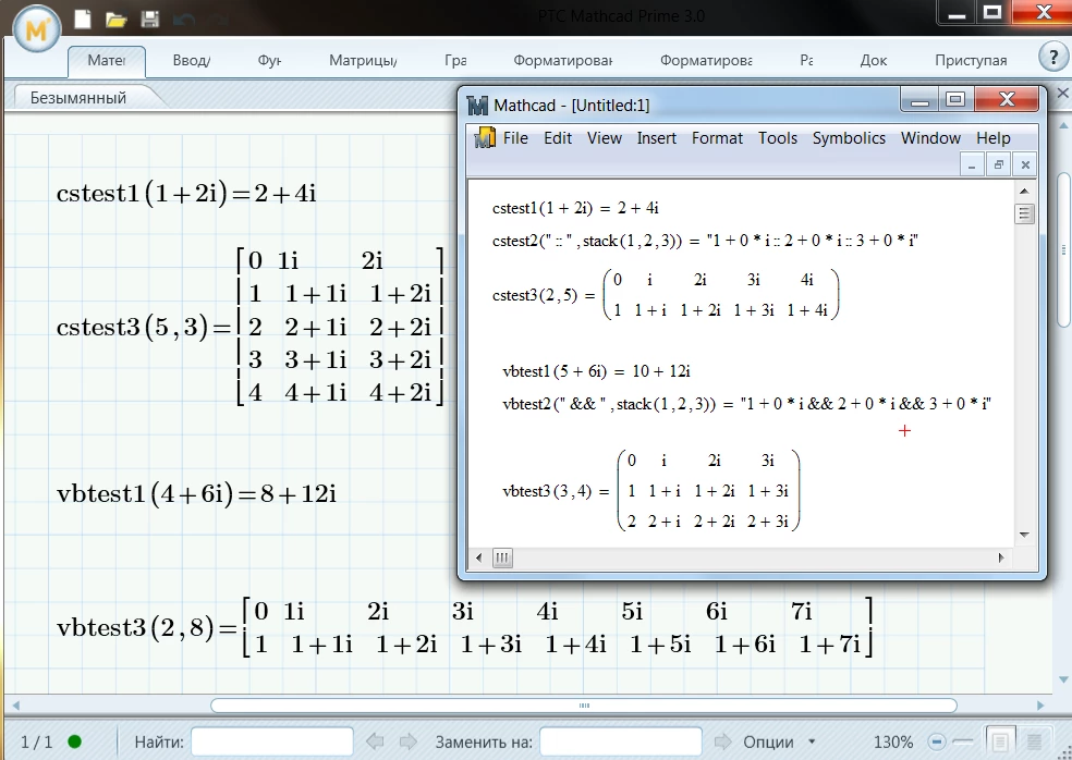

Tested for MC15 M050 x32 and MC Prime 6.0 x64. Now you can use .net (c#, vb.net, c++/cli) user functions in x64 Mathcad Prime.

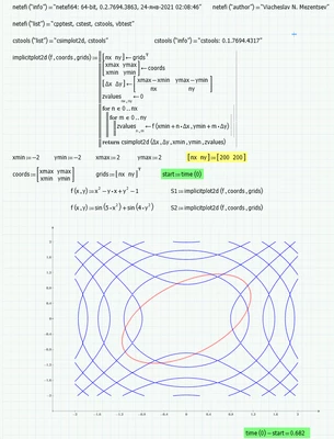

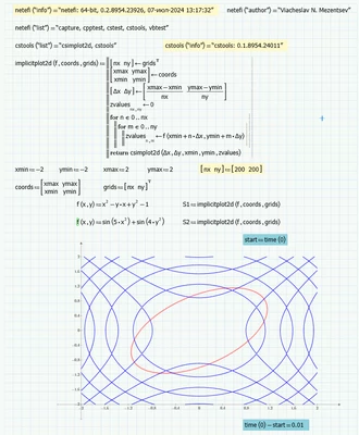

January 23, 2021

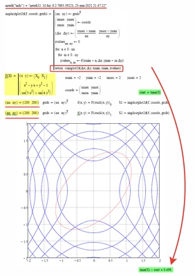

Now we can increase the speed of calculations. In this example in 5 times. Part of the function is implemented in the plugin.

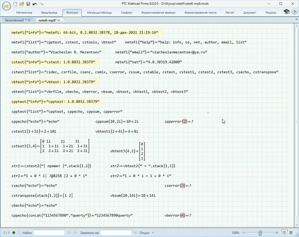

March 31, 2022
Mathcad Prime 8.0 x64 also supported.

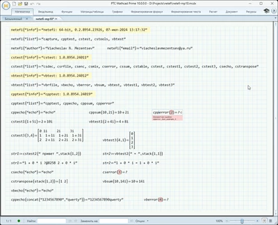

July 7, 2024
