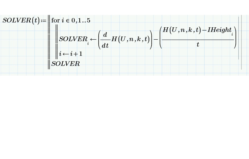

I am trying use root on the odesolve result. But I cannot , can someone let me know how to do it? It said it is out of the range.
October 30, 2012

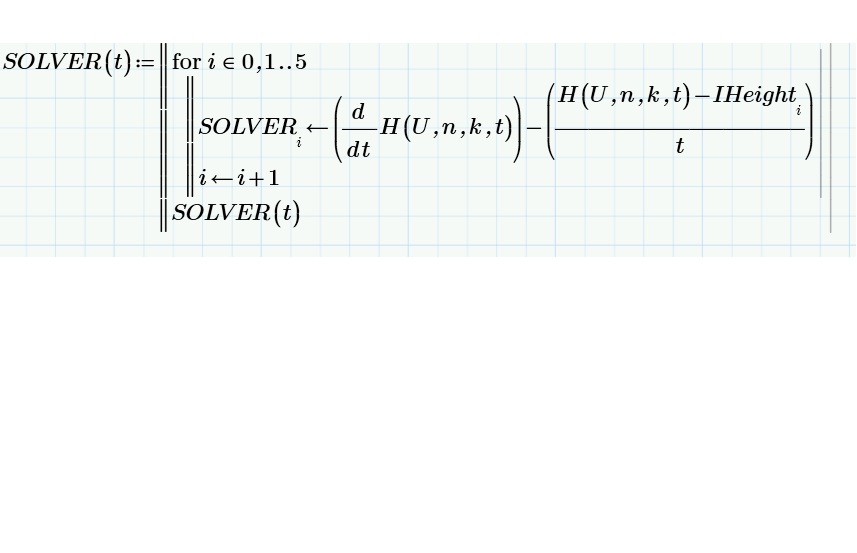

I can understand Valery's example, but I do not know what is wrong with mine. Can someone tell me? BTW, what is the difference between
and
When should I use a function(t) like Valery does in his example and when should I use the function at the end of my program?
October 30, 2012
You can get it to work by replacing the dH(U,n,k,t)/dt term by the the gradient term as it appears in your ODE solve block (ie U.(1-k/H)^n or whatever it is). The results are values of time not values of the SOLVER function. However, what exactly are you trying to achieve here? The SOLVER function as it stands doesn't make much sense to me.

October 30, 2012
Thanks, Now I get it.
Would you or anyone tell me the limitation of the derivative function? Like in this case, since I defined dH/dt = f(H(t)), I can replace it with f(H(t)) to do calculation. But in the case if I dont have f(H(t)) , I am forced to have mathcad calculate dH/dt, how can I avoid running into problem like what I had or how to spot a potential problem which would not allow me to use dH/dt directly?.
My function is to found a series of linear line that has a specified y-intercept and is tangent to the function of the curve fit, which is H(t). What I am really interested in is the slope of that line. So I first find where the linear line make tangent to H(t) and then find the value of that tangent slope. Can someone suggest a different way to do it? Or How should I write my program to skip finding "t" where the linear line is tangent to the curve and the solve for tangent slope? Is there a way to find the tangent slope I want directly?
What are other methods to acheive the same result? I want to learn more method
BTW, go back to my question about program.
When I define a function f(t) = some program,
what is the difference for using f(t) and f as the last line of entry in the program? Like in the two images I posted earlier, (the one with SOLVER(t) gives error, but the one with SOLVER work fine). But sometimes I see program ending in f(t), such as Valery's example
I am confused with their meaning.
Henry
