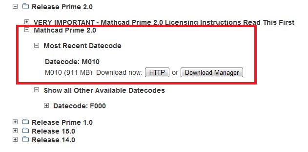

Hello!
New service release M010 of Mathcad Prime 2.0 is available under "Order or Download Software Updates" on PTC's site, here: https://www.ptc.com/appserver/cs/software_update/swupdate.jsp

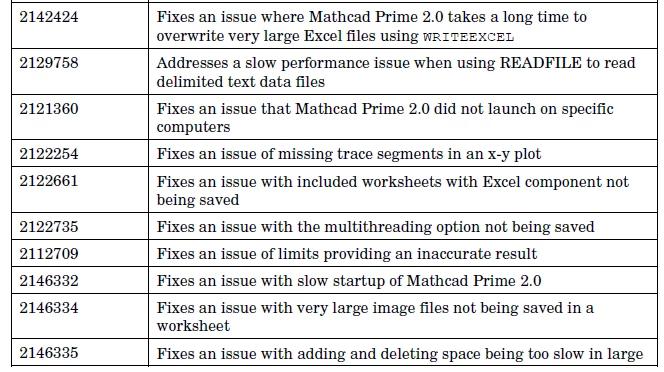

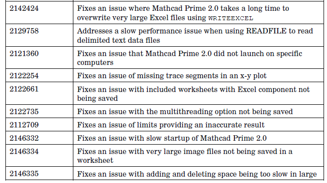

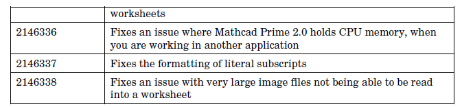

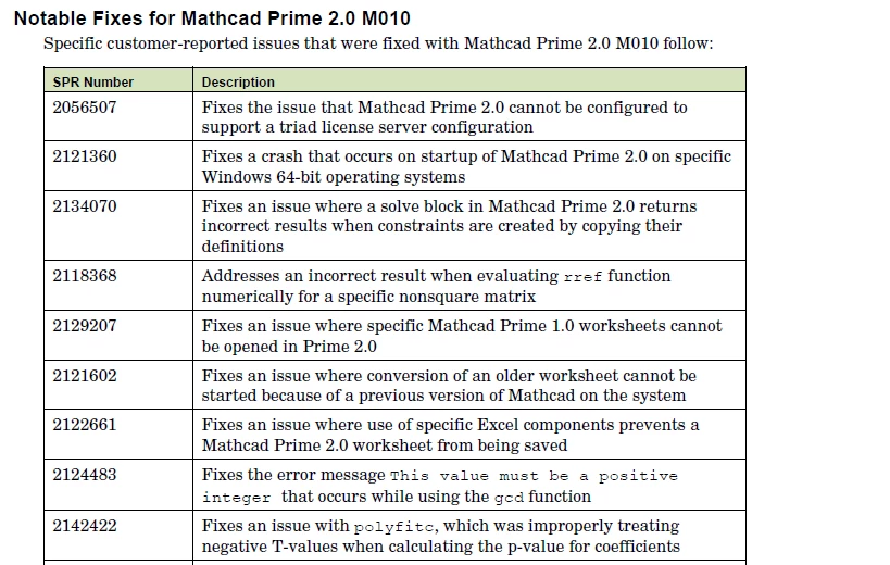

List of bugs fixed in Mathcad Prime 2.0 M010:

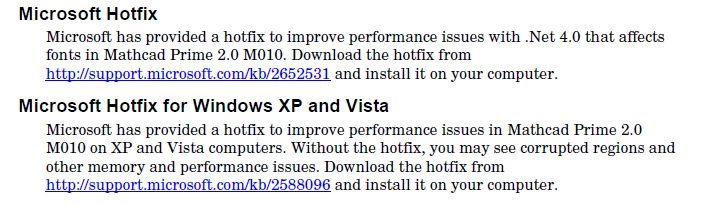

Microsoft Hotfix's:
http://support.microsoft.com/kb/2652531
http://support.microsoft.com/kb/2588096
PDF "Read This First" guide for M010 service release can be found in the attachment.

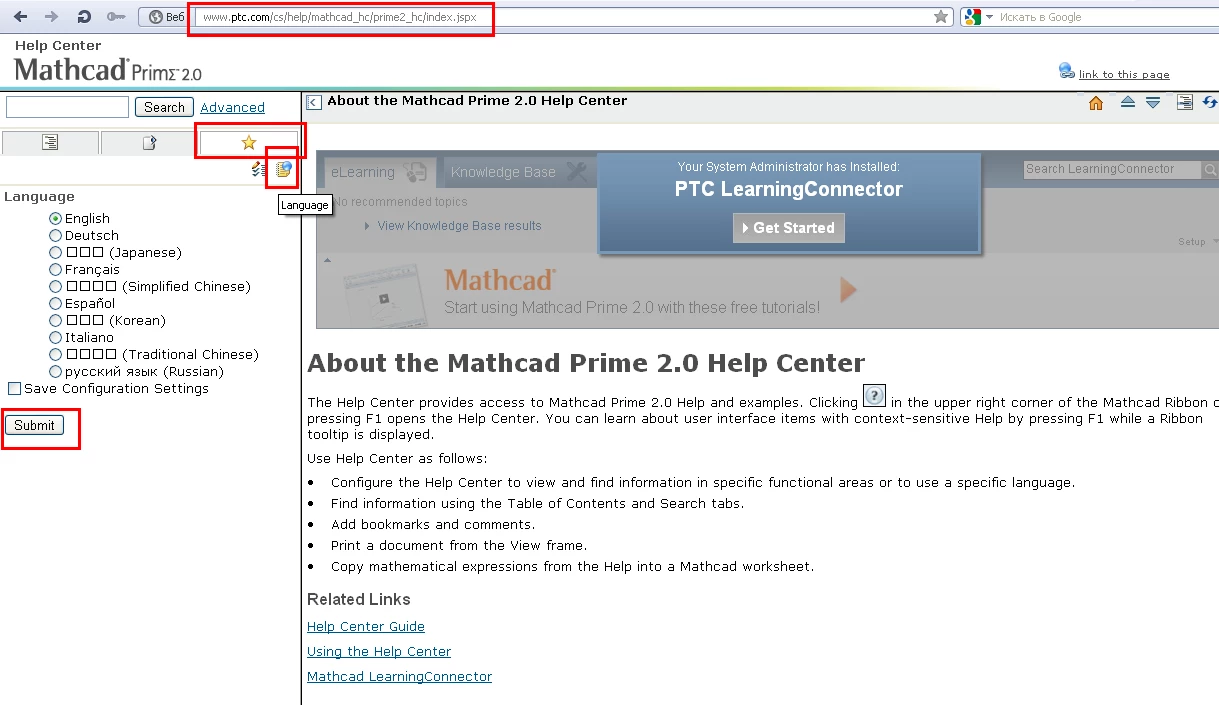

"Mathcad Prime 2.0 Help Center" now is available on the Internet (it works better with Internet Explorer): http://www.ptc.com/cs/help/mathcad_hc/prime2_hc/index.jspx
You can choose your language by clicking on the tab "Configuration" (yellow star) and then select "Language":

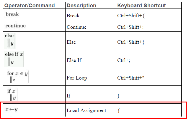

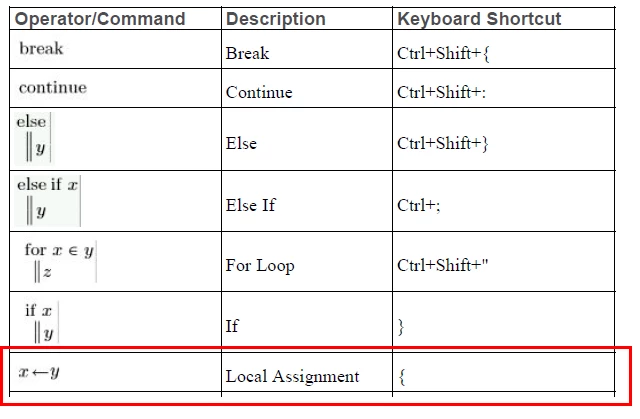

The keyboard shortcuts pdf still is faulty. E.g. "{" is unfortunately NOT a shortcut for local assignment as it used to be.
VladimirN24-Ruby IVAuthor
February 9, 2013
Werner Exinger wrote:
... "{" is unfortunately NOT a shortcut for local assignment as it used to be...
This only works if you press "Shift + {".
