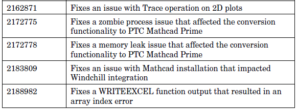

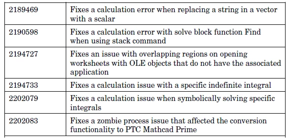

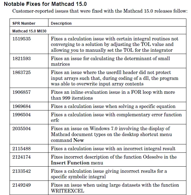

Recently released a new service release of Mathcad 15 M030. List of bugs fixed in Mathcad 15 M030:
PDF file "Mathcad 15.0 M30 Read This First", which presented a list of bug fixes, can be found in attachment.
Note that the manual "Read this First" and "Installation Guide" can be found in "Help" menu with first run the installation package of Mathcad.

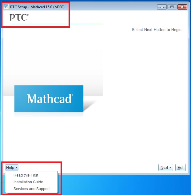

I have an installation of this version M030 problem.
Whatever the directory where I want to install, it is denied.
Even though I chose the directory MathCad 15 M020, or it is installed, the installation is rejected.
The exact message is:
The selected installation directory C: \ Program Files \ Mathcad \ Mathcad 15 exists but does not include PTC product invalid. Specify a nonexistent directory or an existing Mathcad directory.
I tried all the combination, but it will not boot. If you have a solution.
Cordially.
Denis.
December 21, 2013
I encounter the same problem. This seems to be a bug in the installer.
But you should be able to install in a different directory (e.g. type "Mathcad15" instead of the default "Mathcad 15"). Your older version is recognized nonetheless, gets uninstalled and your Handbook and template directories are backed up the usual not really userfriendly way. Save your license file before installation.
