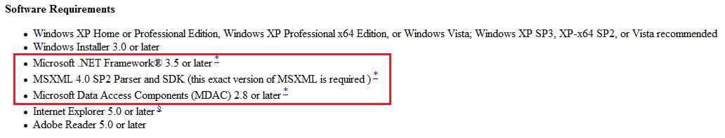

Note that for Mathcad 14, you must have the following components (from Microsoft) preinstalled on PC:

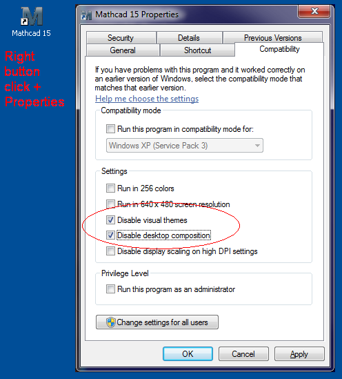

Try please change this:
