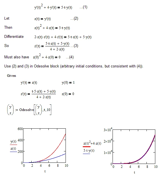

You can turn the non-linear y'(t)^2 + 4y'(t) = 5ty(t) into two simultaneous linear ode's:

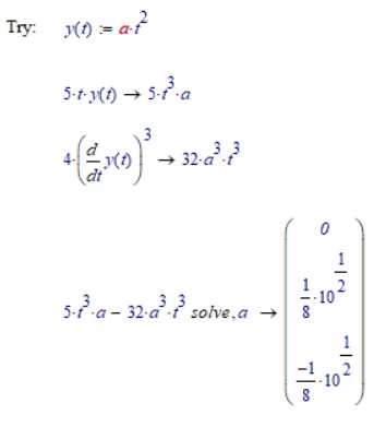

Hmm squared.... Seems more like to the 3rd power.
You have (y'(t))^2 and mutiply that with 4 y'(t), that gives 4*(y'(t))^3...

Found it.
Try y(t)=+/-(1/8)*sqrt(10)*t^2.
The third solution is y(t)=0, but I guess you weren't looking for that.

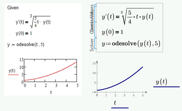

Here's a possible workaround for a numerical solution, both Prime and real Mathcad:

From Mathcad's documentation of "odesolve":
The ODE must be linear in its highest derivative term,
