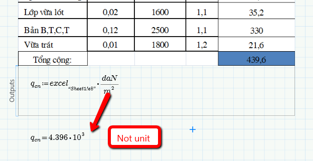

Hi all.
I is prplem.
Please see picture.
I is attachment file.

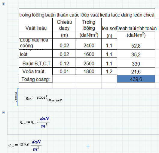

Best answer by ValeryOchkov
Yes, it is a bug.
I must do so:
September 27, 2012
Yes, it is a bug.
I must do so:

Thank teacher.
