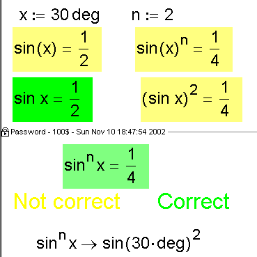

May 6, 2011
In 2002 I knew how to do it! But now...
See my old tip for Mathcad users!
I must search the Mathcad file!
(sin x - no problem by help the prefix operator)

May 6, 2011
I really don't see the issue here.
I provided an example without the need to use the prefix operator.
For sin(x^2), but not for the others, such as sin^2 x. Some can only be done with the prefix operator.
