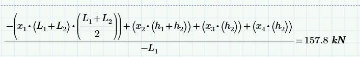

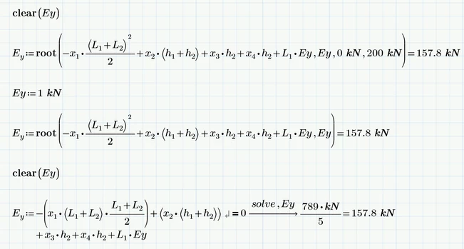

To solve this simple equation numerically you may either use a solve block or the "root" function in one of its two flavors (either provide a range or a guess value).
An1d, no - you can't insert a line break where you like - it must be at an operator (+,-,*..) and the symbolic arrow will still show to the right of it, making for an even uglier display:
You may consider going to the calculation option and check "Use units/constants in symbolic math"
