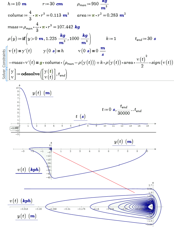

A man jupping into water from a 10 m tower. How deep he will sink into water?
A "man" is a ball with r=30 cm and Ro=950 kg/m3
September 4, 2012
One solution - new very interesting attaractor:
September 4, 2012
Strictly, Valery, you should test to see if the flow is laminar or turbulent. If it is laminar then the resistance should be linear with velocity .i.e. proportional to v rather than v^2. Nice attractor though!

September 4, 2012
Alan
Thanks Alan - I know it. We must think not only about Ro but about Re too!
It (see above) is only simple Math model.
I would like to collect a set of same task for students. Help me please!
