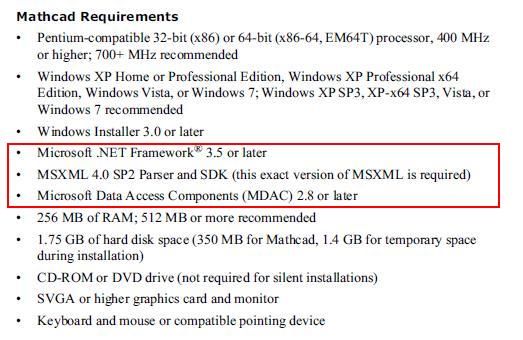

September 14, 2011
Check if you have on your computer, the following components installed:
