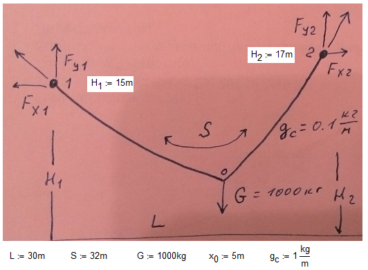

You you already assume that the left and right part are catenaries.
Just a quick idea (without closer thinking about): Lets look at the left side. This catenary has its (imaginary) lowest point at x01. Somewhere between Point 1 and this lowes point is the weight G. Shouldn't the weight of the chain from the point of the weight G and its lowest point (x01, that is the weight of the chain that doesn't exist) be the same as G?
At first sight I stumbled over the assumption Fx1=-Fx2 but i seems to be OK, I guess.
23-Emerald I
October 28, 2013
In a catenary, the horizontal tension is constant.
You can develop enough equations to find a solution.
October 28, 2013
Yes - in the point 0 too
Thanks, Fred. I have lost my dream...
But change please H1, H2, G etc and see the plot.
23-Emerald I
October 28, 2013
I don't see a problem. You can set up the solve block as a function.

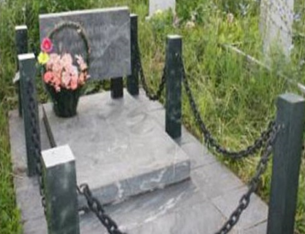

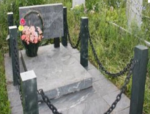

I see a part of chain:
It may be so
or so (the load is fixed or very slow moves).
Or?
November 2, 2013
Valery Ochkov wrote:
I think we can show it without DE - with a simple logic.
OK. What is it we should see? I guess you mean we see an ordinary catenary, right?
It may be so
OK.
No! Not OK. You already assume that a single point load generates a catenary to "show" that a single point load generates a catenary.
You can easily prove that the square root of 16 is 5 if you first assume that 5^2 is 16.
Thats TOO simple logic 😉

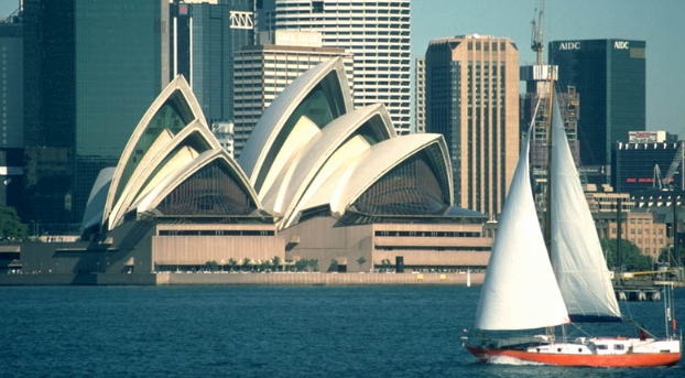

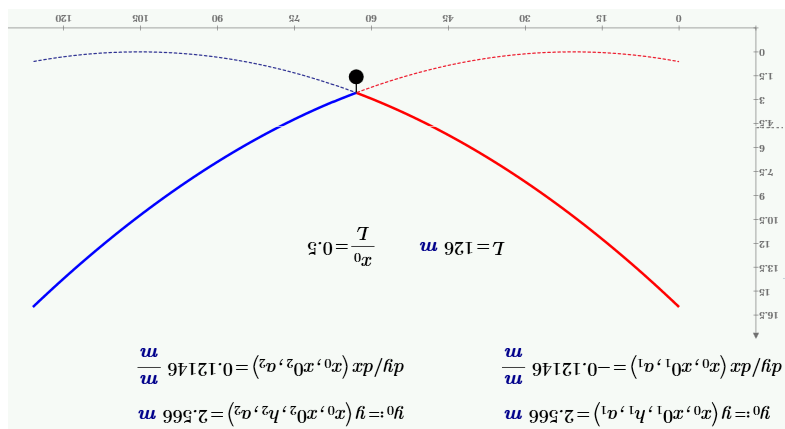

Allen Razdow (the author of Mathcad) has said me that in Boston or Cambridge is one building with the walls as cateneries.
I think it is our problem in Australia (two parts of an arch):
You can turn your notebook or tablet in ailartsuA and see a catenary
November 2, 2013
No, but its very often read that the Sidney opera house shells form a catenary. Its not true. The architect Utzon himself had changed the construction using his "spherical solution".
Also the original ceiling of the concert hall consisted of reverse catenaries but the design had to be changed (I think that was made after Utzon left Australia, but I'm not sure about that) because of acoustic problems.
Some readings:
[1] Daryl Dellora, Utzon And The Sidney Opera House, Pinguin Special
[2] http://www.fpv.umb.sk/kat/kf/Integrovana_prirodoveda/SG/Zvuk/Sluch/Online_Course_on_Acoustics/opera_house.html
Citation from [1]: "This posed the conundrum of what kind of form should be employed for the shells. Should it be an ellipsoid? A parabola? A catenary? Work on this difficult mathematical problem took up thousands of hours of the engineers' time and expertise - a staggering 150,000 hours by February 1962 - and yet after two years they were no closer to resolution. Finally Utzon solved the problem himself: with a unique mix of aesthetics and mathematics, he developed his famous 'spherical solution'.
At its simplest, this meant that every element in each of the shells would be taken from a sphere of the same radius. It followed that the manufacture of these elements could then be done uniformly and cheaply. The spherical solution also carried with it the solution to another perplexing issue, the question of the
shape of the tiles that were to cover the shells. Once the curvature of the shells was determined to be spherical, it followed as rudimentary geometry that the tiles should be square."
Citation from [2]: "The original ceiling consisted of large 'reversed' arches shaped like catenaries hung longitudinally from the external shell [cf: Figure 1]. However, model testing showed that the orchestra area suffered from a deficiency of early arriving sound meaning that the direct sound dominated over the early reverberant sound and the influence of lateral reflections was negligible. Adding suspended reflectors over the stage did not substantially change this situation. It was therefore decided to raise the ceiling substantially and reduce the distance between the side walls."
