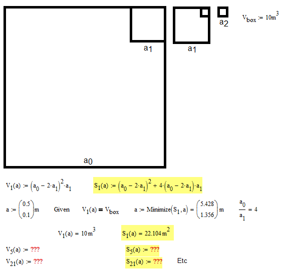

What can you say about this new fractal optimization problem?

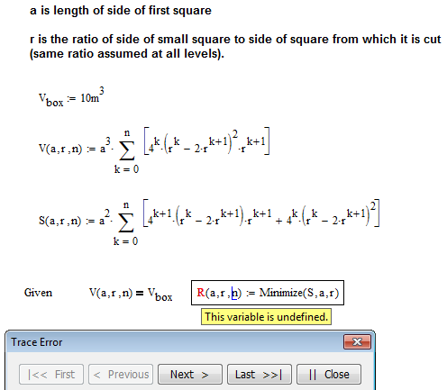

Valery, here's my attempt.
Alan
October 25, 2013
Thanks, Alan.
And V is not 10 but 10m^3
October 25, 2013
Valery Ochkov wrote:
Thanks, Alan.
Easily fixed!
