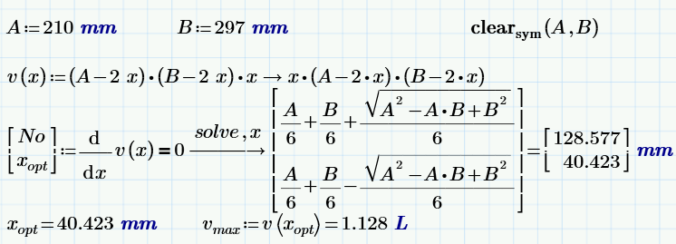

Do you know one symbolic solution of this problem?
See please one numerical solution in attach (M15):
PS At A=B x=A/6

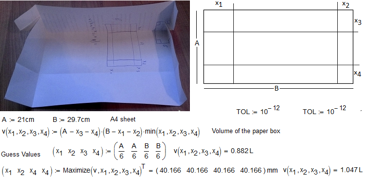

First guess - x1=x2=x3=x4
October 14, 2013
Sorry, I cannot correct solve this problem numerical
In M15 and P3 - see please the first picture, this picture and attach.
October 14, 2013
Set up four different variables to solve for: x ... the smallest of the four and you may say its at the side A - that way changing A and B could (not in this case) yield a different result. The other three variables are the differences Delta1 .. Delta3. So wie have V(A,B,x,delta1..delta3):=(A-2x-delta1)*(B-2x-delta2-delta3)*x
That way you get rid of the min() function which is the problem.

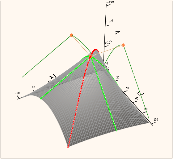

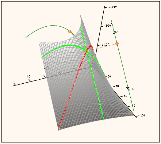

In case of Valery's 4 variable extreme value problem (which in reality is only a one variable problem) the various objective function would represent a 4dimensional surface in 5-domensional space. This is a little bit difficult for the imagination, so I reduced the problem to just two parameters. I assume that the bent-over lateral surfaces of the box on opposite sides are equal. That way we can visualize the objective functions as 2D-surfaces in 3D space - a bit more comfortable.
The problems that have so far emerged in this thread are:
1) Why does Maximize fail with Valery's objective function using the min() function?
2) Why do the partial derivatives don't evaluate to zero at the solution point
3) Why do we not arrive at the solution by setting the partial derivatives to zero, neither with Valery's, nor with Alan's objective function.
I played around and the attached sheet emerged. As far as I am concerned the answers to the questions are:
1) because min() introduces a discontinuity in the derivation of the objective function, there would not be a unique derivative in the area of the solution and so the CG algorithm, which uses the gradients to approach the solutions, fails
2) & 3) because the solution is not a local maximum of a continous differentiable function.
Any suggestions?
Here the 2D/3D objective functions of Valery and Alan

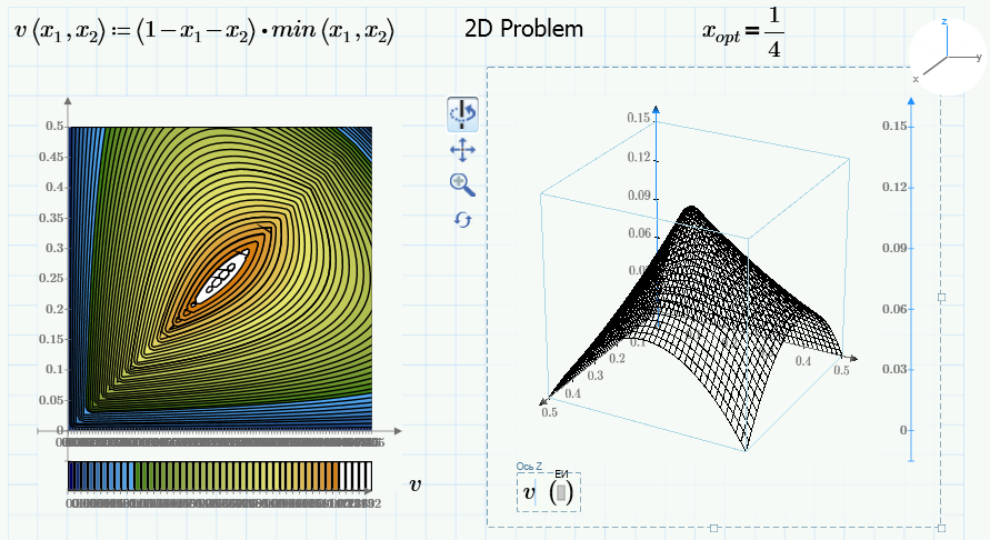

2D variant of this problem:

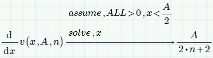

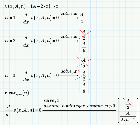

This "quadrate" problem in a N-field - see the picture.
Do you have any solution for a "non quadrate" problem with the function v(x, A, B, n)?
October 15, 2013
If you think in n dimensions and want to go from the hypercube to a hypercuboid (? I am absolutely not sure about the wording here), we would not only have A and B but rather A1 ... An !
And as the discussion has shown here, we can not be sure that the solution would be a local maximum of the objective function.
Good luck!
BTW, you could try to constrain x<A/2 with assume to get rid of the unwanted "solutions".
