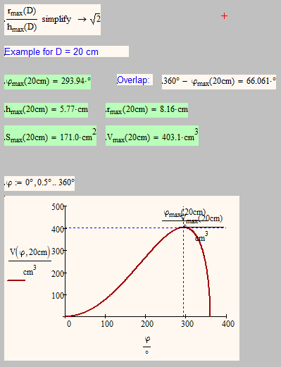

OK, here is at least the volume optimization.
Oct 16, 2013 5:10 PM UTC
My old solution:
http://twt.mpei.ac.ru/ochkov/Mathcad_12/3_01_Bucket_Functions.png

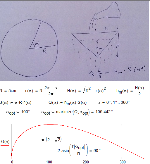

The first guess of the solution:
Oct 19, 2013 1:05 PM UTC
Q = ?? (surface of the whole cone times half of the height)
