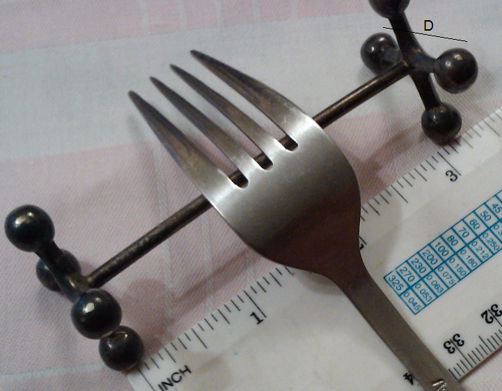

The main task (for Mathcad and Creo).
I would like to make this stand for cutlery (see the picture). What form must have this cutlery with minimal mass - see PreTasks above (D=3.5 cm L=8cm d=3mm Density=10.5 gm/cm^3 - silver for example):
