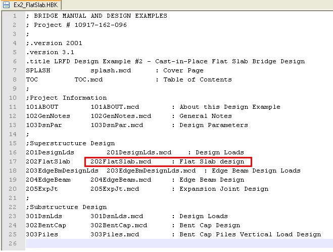

I am trying to work on a Florida Department of Transportation file to design a flat slab bridge, Ex2_FlatSlab.HBK, but cannot do so. I've opened the document but all I get is a blank page, none of the file is shown. What am I doing wrong?.
Best answer by Werner_E
The file you posted is not a file you are supposed to open in Mathcad. Its part of a so called mathcad e-book. This *.hbk file is simple text file and represents sort of an index. It lists the names of all the mathcad-files which belongs to that handbook (in your case it consists of 13 files).
The *.hbk file should be located in the subdir "Handbook" of the installation directory of Mathcad (15 or below). The Mathcad files this handbook consists of, should be in a further subdir of handbook with the same name as the hbk-file, so e.g. they should be in "C:\program files\Mathcad\mathcad 15\Handbook\Ex2 FlatSlab\"
If the handbook is installed that way on your computer, from within Mathcad go to Help/E-Books and in the list you should find your handbook to browse. While they are normal MC sheets they are protected in some way to help preventing changing them. They are supposed for reference and you can copy expressions from there to your worksheet.

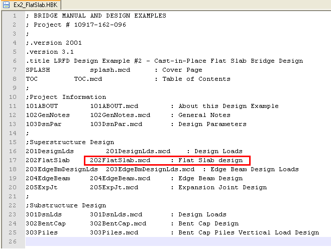

The contents of your file (the contents of e-books for Mathcad):
For flat slab design you need "202FlatSlab.mcd" worksheet. In attachment can be found PDF file "Cast-in-Place Flat Slab Bridge Design" with the listing of the program (from Florida Department of Transportation site): http://www.dot.state.fl.us/structures/StructuresManual/CurrentRelease/FlatSlabExample.pdf

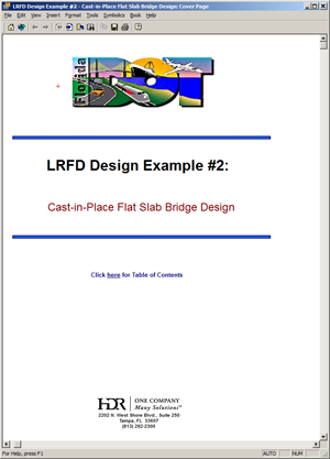

August 21, 2013
Ok, so when I download and install it, it copies files into the 'c:\fdot_str\designexamples\flatslab' directory.
Open up Mathcad. File > Open > change File Type to 'Mathcad Books' > browse to the aforementioned directory > choose Ex2_FlatSlab.HBK
You should now see something like:

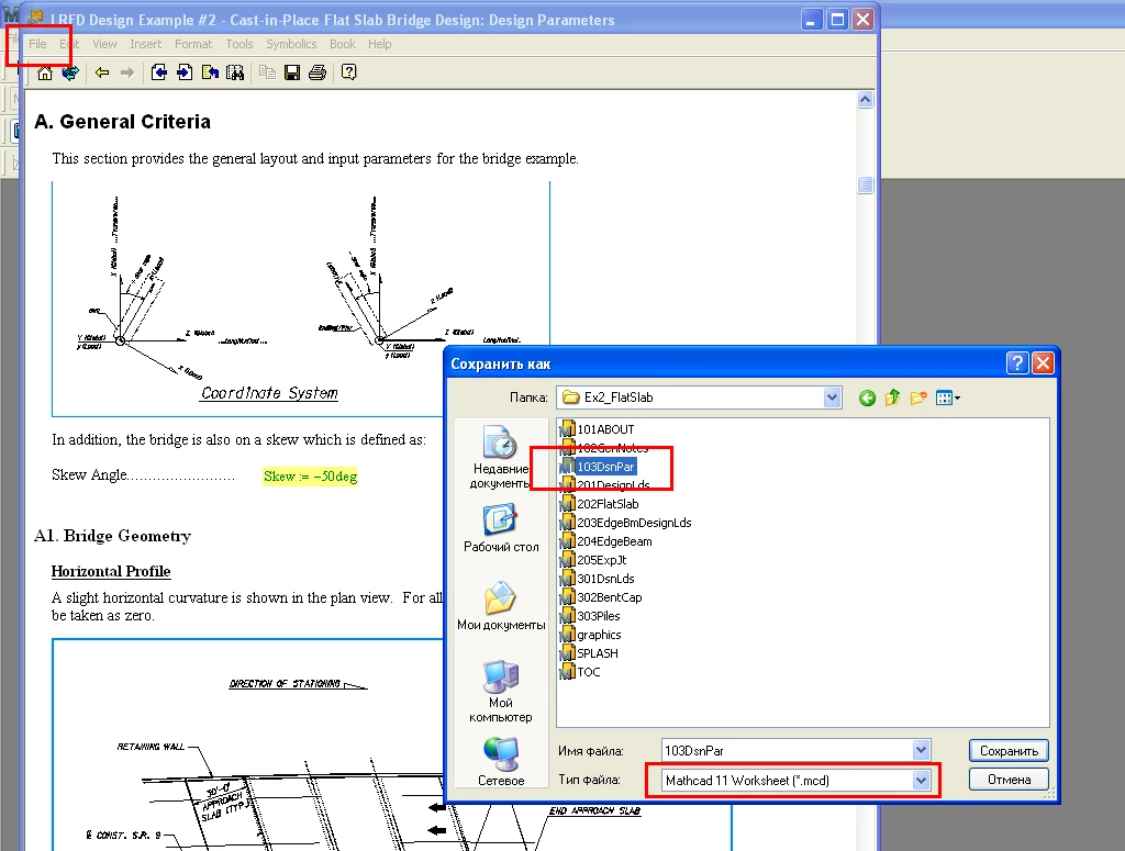

Mr. Yeh: Thank you very much we are a lot closer now. I was able, as you instructed, to open the file in the *.hbk format. I went to the first part, 1.03 Design Parameters and made all the changes as per my project. Pressed ctrl-F9 accordingly to apply the changes.
Then comes the problem: the changes made do not transfer to the next step! What do I need to do to make sure the changes made in the earlier file are transfered to the following file?
August 21, 2013
You need to resave the file (in maim menu of this ebook select "File" -> "Save As" -> "Mathcad 11 Worksheet (*.mcd)"):
