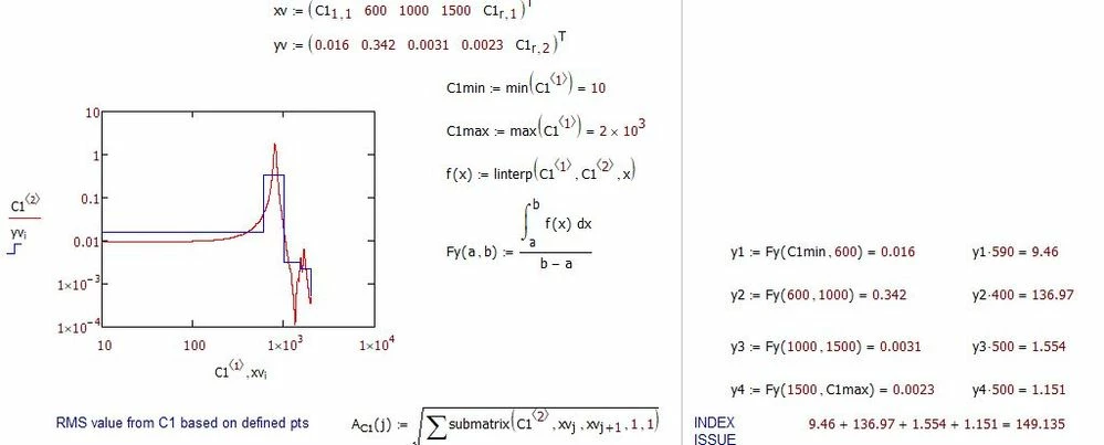

I have a curve C1, define between [x1,xn] and I would like to create a curve C2 using N pts so that some criteria are met. Essentially is a “double optimisation” problem. Consider the following; I want C2 to be made of p points p(xi,yi) – Generally a few points (say no more than 10)
Criteria 1:-  xn > xn-1 > x1 . xn and x1 are given
Criteria 2: In a given x range [xn,x+1] rms C1 ~ rms C2 . Within a given a tolerance (say +/-1%).
Is there of way of using Mathcad to find the best pair of points to meet criteria #2
Does it require some sort of loop, or is there some built-in optimisation tool one can use
Attached a mcad 15 file swith some preliminary stuff - Not much

Is this what you mean by finding the y values?

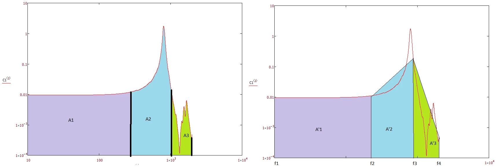

imagine the following. Using the Simpson method for integration by splitting a range [a,b] into n equivalent length. Let’s say I split this range into 2 rectangles. It’s fairly easy to find the “middle” point so that the area A of each rectangle is close to the exact integral
what I am thinking at the moment is if there is a way of “automatically” finding the best positions of say N points so that the area in each “bin” is a close match. If the raw data as a x increment =1 over say [10-2000] range then choosing 1990 points would be an exact match
With the attached diagram
I split the range into 3 areas . I therefore "decided" I want to use a vector {f1,f2,f3,f4} in all cases f1 and f4 are "fixed" i.e. decided by the user. I therefore will have a vector y={y1,y2,y3,y4}
Is there a way of finding the best values for (f2,y2) & (f3,y3) so that
area sqrt(A1) ~ sqrt(A'1); sqrt(A2) ~ sqrt(A'2) and sqrt(A3)~ sqrt(A'3) where the A areas from Curve C1 and A' the areas from the points I am trying to establish

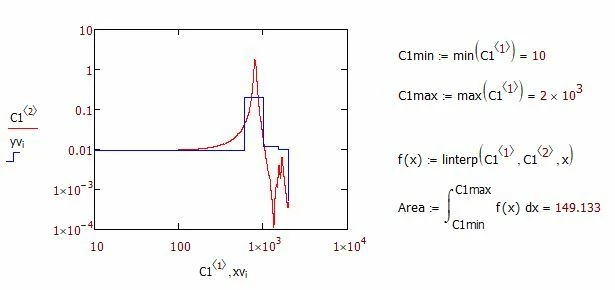

also added a mcad 15 example but needed 5 pts to "look" good. Not checked the areas,etc

"what I am thinking at the moment is if there is a way of “automatically” finding the best positions of say N points so that the area in each “bin” is a close match"
look up "Gaussian quadrature" on the internet for exactly this problem and solution.

Did some searches on the Gauss integration-attached pdf. It is what I am trying to do but I do not know if the "solving" can be done in mcad. I suspect it can. Might be a minimisation problem! I think I started laying out the problem  a bit better and the "key" step is how to use and set up the 'Given' block
