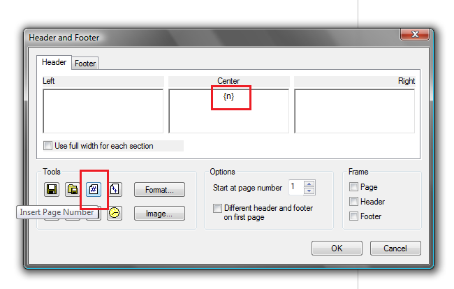

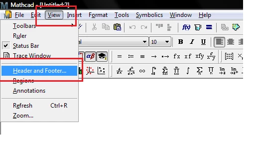

In main menu select "View" -> "Header and Footer" -> "Tools: Insert Page Number":

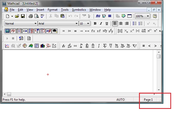

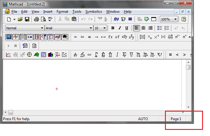

...is there a way to determine which page is which?...
You can find the page number in the lower right corner of the program:
