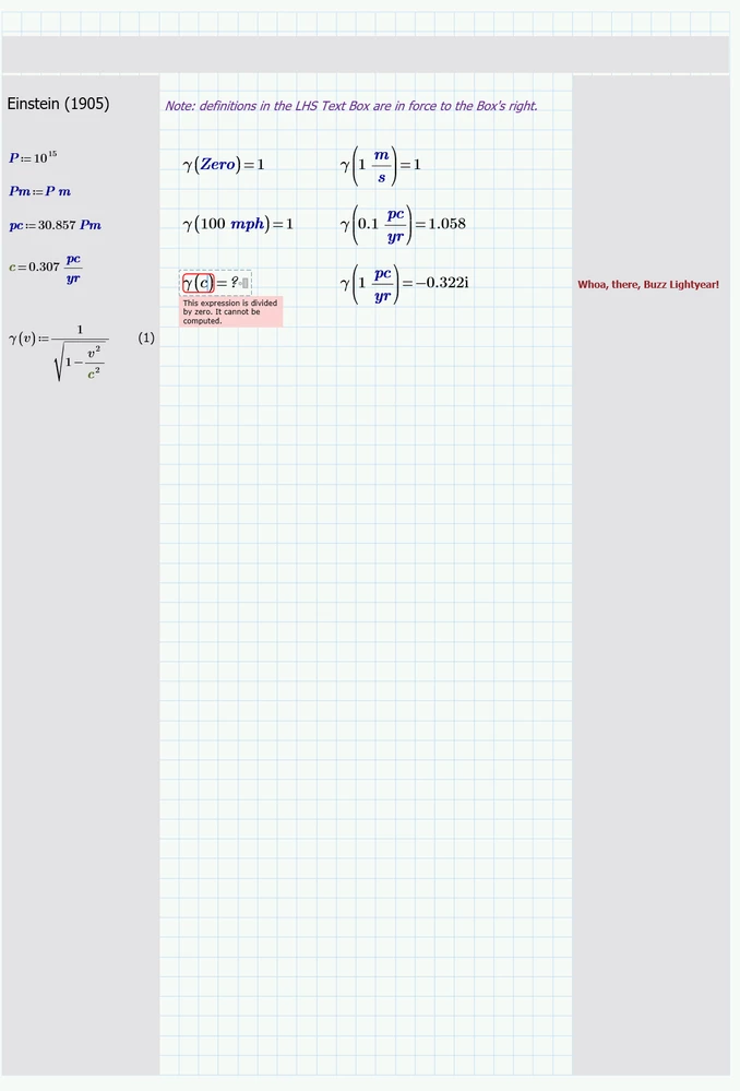

In addition to Werner's suggestions,  You could also have a look at using narrow Text Boxes.  There isn't a border option for Text Regions, which is a pity, so shading is a possibility or vertical lines.   However, the big caveat is that definitions that appear in a Text Box are in force to the right of the box's position marker (near the left hand top corner).  I've occasionally used this technique to give the impression of multicolumn flow.

Prime only has very modest and limited text processing options. Multiple columns, vertical guides etc. are not included.
You would therefore have to take care yourself to place the calculation expressions only within the middle area, to prevent the results from “overflowing” into the right-hand column (e.g. by selecting a smaller font size for the relevant region) and could at best try to realize the vertical lines by including graphics. Similar applies to the header.

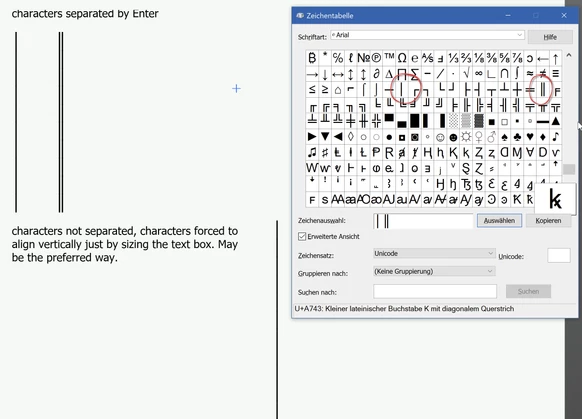

Another option which comes to my mind is a text field with ASCII graphic characters taken from Windows' character map:
Prime 10 file attached

Nov 5, 2024 3:27 PM UTC
Thank you very much. I think thsi is the only way to seperate them, I will make and save it as template. it would be nice if such modifications could be added on the software, these are the best ways to show engineering calculation while giving reference to standards and comments.
