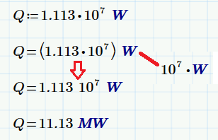

April 10, 2013
Sorry Werner,
I have attached the work sheet. I have also highlighted the areas of concern I have with red text
Mike

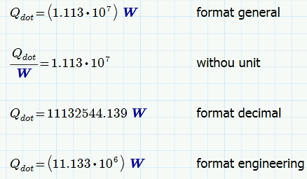

April 10, 2013
I wasn't aware of this as I usually use Mathcad and not Prime.
It seems to be a setting PTC had chosen for Prime differently to Mathcad to clarify what number a unit belongs to. It shows up when the number is formatted using scientific (or engineering) format with a powers of ten in combination with a unit. Its a setting which you cannot change, I guess. Without the parenthesis you could believe that 10^7 has the unit W and 1.113 is unitless - most people won't care, I suppose.
