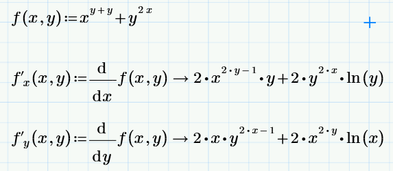

Is partial derivatives functions are disabled in Mathcad prime? I have used mathcad 15 to create a set of partial derivative equations (XMCD file), and converted it back to mathcad prime (MCDX file) since i do not know how to acces partial derivatives in Mathcad prime. But, it comes up as set of equations with usual derivatives (d/dx type). If someone is there who knows how to use partial derivatives in mathcad prime, please let me know how to do it. Thanks
Best answer by ValeryOchkov
We have in Mathcad 15 a symbol and an operator of the partion derivation.
We have in Prime only an operator of the partion derivation.
We can do so in Prime and in Mathcad 15:
February 22, 2014
February 23, 2014
Thank you very much for the reply. Yes, i can understand it now. But when I initially looked at (f') function, it says 'returns the firtst variable of single variable function', i was caught up with single variable. Anyway, now i know where to go. thank you very much.
