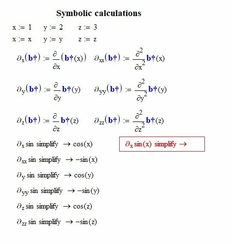

How can I modify the operator so that it works correctly and not as shown in the figure? In the image what I would like is marked in red:
I used a letter linked to the sword symbol (but I could have used others) because when it is used as an argument of a function in a reference file, it is sure that, in the calling program (s) (in which I will be careful not to use that symbol, linked to the sword symbol), no conflicts arise.

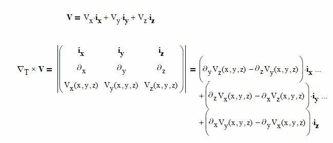

I would need something more than previously said. For example, use those operators in the rotor calculation as in the figure:
symbolic 1.jpg,
is it possible?

I'm afraid not. And I doubt if the operation, defined through the determinant, is mathematically correct.
Anyway, if all items of the 3x3 matrix are just symbols, this is what you get:
So it looks great, until you look closer. In the first term of i.x, the partial derivative to y is not applied to V.z, but simply multiplied with it.
With the partial derivative 'operators' (in fact they're defined as functions) defined you're getting undefined items.
