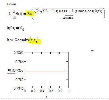

Two problems in your MC15 sheet:
1) wrong syntax of Odesolve (you don't have to provide the function name theta in MC15)
2) the expression on the right hand side of your ODE takes non-real values if theta goes above 45 degree
I coped boldly with the last situation by applying the Re() function 😉
Now you get a solution, but its constant 45°
May 11, 2020 4:05 PM UTC
Thanks!
But why I get a constants, not a function - angle of the pendulum as function of time?
May 11, 2020 4:17 PM UTC
Total energy is constant throughout, so the value under the square root sign of the numerator of the RHS of your ODE is always zero; hence theta goes nowhere (as you can see from Werner's graph)!!

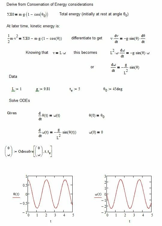

May 11, 2020 4:06 PM UTC
If you wish to get the equations of motion from conservation of energy Val, you need to do the following:
Alan
May 11, 2020 5:58 PM UTC
Thanks Alan!
I see my bug!
See please Problem 3 in the Manuscript!
