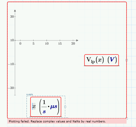

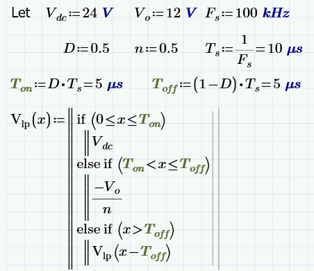

I have been through many posts but i am not able to plot the attached expression. Can you please tell where i am doing mistake?I am expecting a periodic square waveform toggling between +/-24V with on and off period 5us.
Here I used Ton,Toff as a cons; x as a variable and Vlp(x) as a function.
<Unfortunately when instead of Variables I used to substitute assigned Numerical value it works>

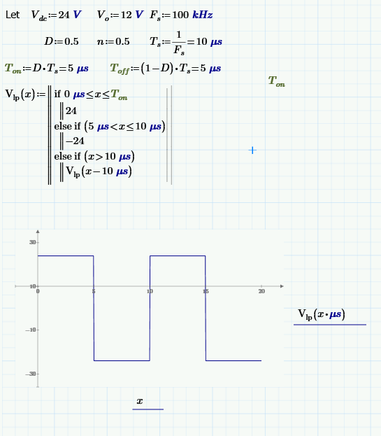

? I thought we'd looked at this before?  You need units in your conditional terms and you need to multiply x by microseconds in the Vlp function in the plot.
Stuart
Assign x as a range variable over the desired range of the plot.
23-Emerald I
By default, when you don't specify a range, Mathcad will plot x from -10 to 10 (IIRC).  Evaluation of your function for a negative number fails, causing your error.  Richard's fix is the correct answer.

sgarg1-VisitorAuthor
Hi StuartBruff
Thanks a ton.
This really works. Sorry i was not getting reply so that is why i posted in other threads as well.  Next time i will make patience.
