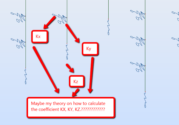

Hi all.
I am design Pile Foundations.
I know there are many ways KX, KY, KZ (kN/m) .You can share how to calculate the coefficient of that for me,????? thank All.

Athur1-VisitorAuthor
April 5, 2013
Thank Fred Kohlhepp.

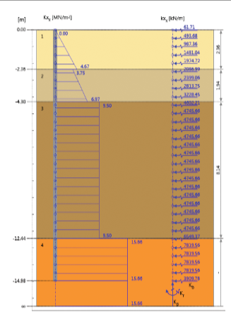

But I want search theory calculate the coefficient same picture.
Please ........
Soft http://www.bimware.com/images/attachments/REX_Piles_ENG_print.pdf
