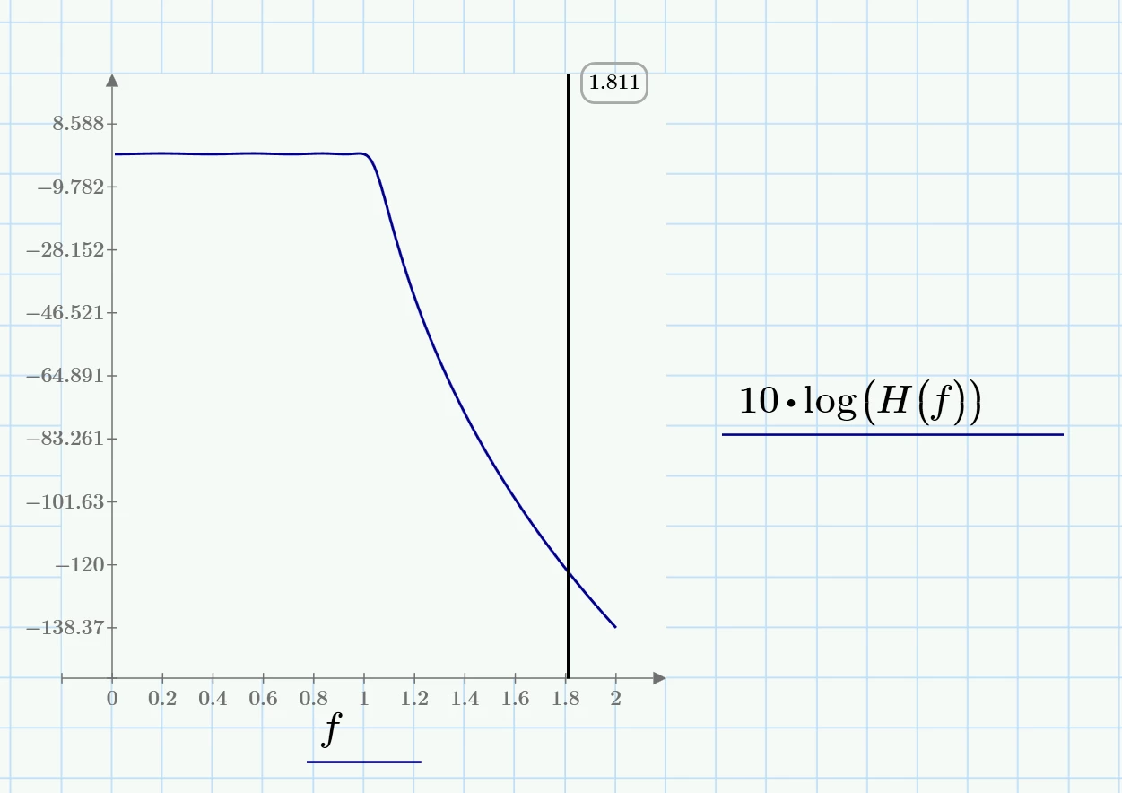

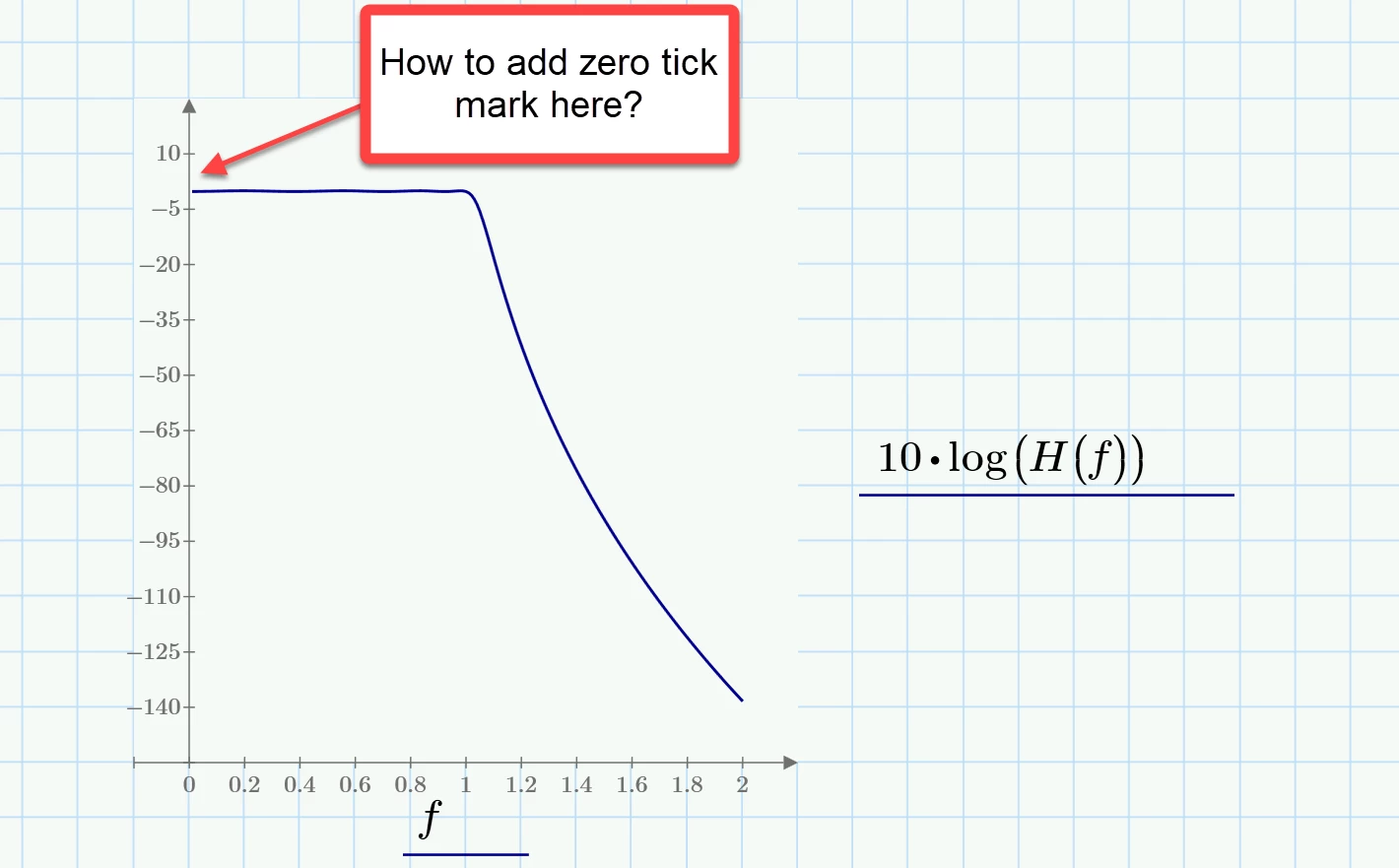

I can’t figure out how to adjust the scale of the y-axis.  Is this possible? (see screen capture)

-125 change to -120.

You can edit the bottom label of the Y-axis, and the one just above that and the top label. With these three you should be able to find a neat distribution of labels along the y-axis that includes 0.
e.g. respectively -140, -120 and 20 should do the trick.
