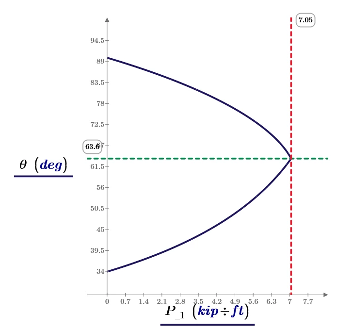

Is there a way to position the plot markers automatically based on a variable value instead of manually typing the value?
The vertical and horizontal markers, which are shown red & green in the attached image

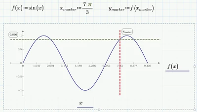

Just type the variable name into the place holder ...

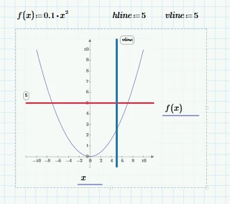

October 30, 2021
Thanks @StuartBruff !
October 29, 2021
Simply type the name of the variable in the placeholder which is show in the upper left of your picture.
You only see the variable names when you click into the placeholder, otherwise you will still see the value, not the variable name.
The pic below was taken while the focus/cursor was in the placeholder for the vertical marker - thats the reason you see the variable name instead of the value.

October 30, 2021
Just type the variable name into the place holder with unitless value as shown below.
