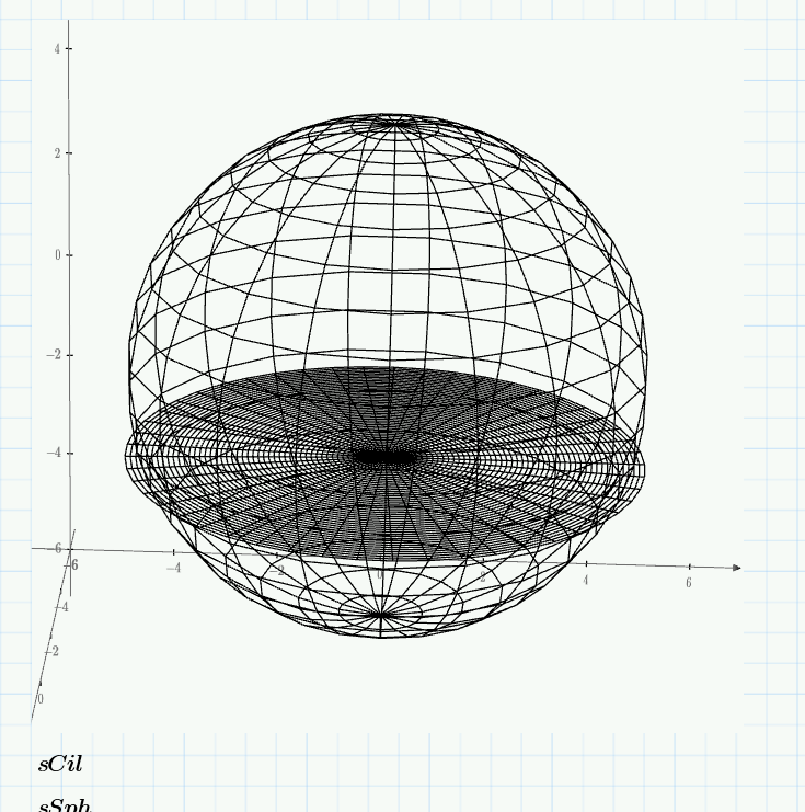

I have a problem with math graphics.

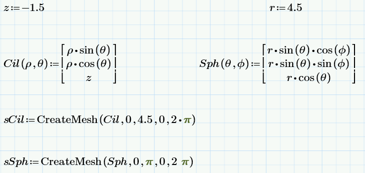

the equation of a cilinder is cilinder(roh, teta) and the shpere, like this: and th final plot, with wrong equation.
I need to draw a sphere with a equation of a cilinder, so I try to z:=-1.5,-1.6..-4.5 instead of Z:=-1.5
But funcion CreateMesh gives error becouse Z is a array of numbers instead a number?

Mathcad's 3D plot can't handle solids. All you get by Createmesh is a mesh on a surface. The same is true for the sphere, too- you just can't tell as long as you draw complete speheres.
In case of the cylinder you may cheat and add top and bottom circular disk - this is what your function Cil is perfect for 😉
Anyway my documentation tells me that input variables are roh and theta..

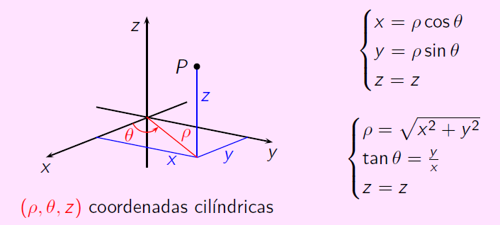

Look at the drawing you provided. Cylinder coordinates are a way to address a point in 3D space, so we need three of them - rho, theta and z.
If z is constant (as in your function) we get a horizontal plan; if we limit r we get a circulat disk in that plane; if we limit theta, we get a sector.
If rho is constant, we get a cylinder with the applicate (z-axis) as cylinder axis. If we limit z we get what most people would image when they are talking about a cylinder surface (most people don't accept that a mathimatical cylinder is endless and has no specific height).
If theta is constant, we get a plane which includes the applicate.

In case of the cylinder your equation is wrong! The radius rho is constant, similar to the radius r in case of the sphere. Any point on the surface of the cylinder depends on theta and z, so these two should be arguments of your function Cil.

If I use theta and z, i will plot only surface of cilinder, and i wnat to plot inside also, like a filed cilinder.
Using thet and z only will draw outside, right?
