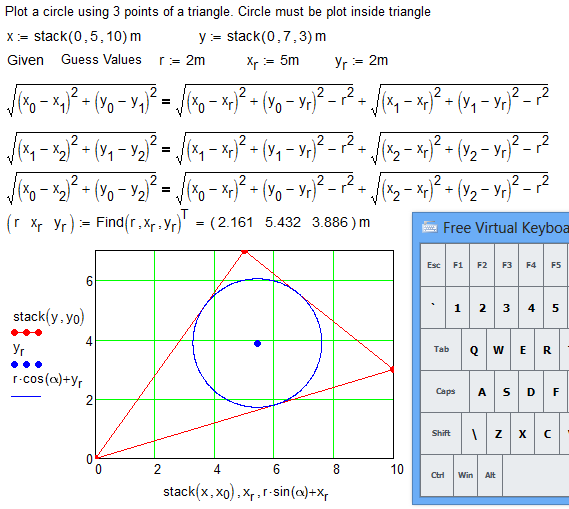

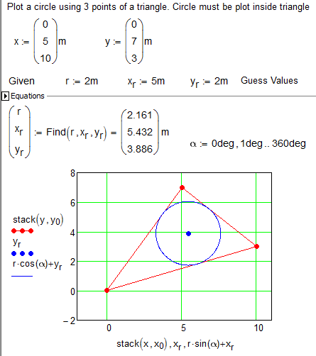

Hello, i am studying master program at mechanical engineering. I am trying plot a circle using 3 points of a triangle. Circle must be plot inside triangle. How can i do? I have done my first homework but second is harder for me. I am using mathcad 15.

Can you solve this problem not thru the using ready firmulas but thru using the Given-Find block

Thanks! But the question was "Can you solve this problem not thru the using ready firmulas but thru using the Given-Find block?"
What is better (for students) - using ready (and unclear) formulas from reference books (and from Werner's solution) or searching own solution based on one formula - Pythagorean theorem:
