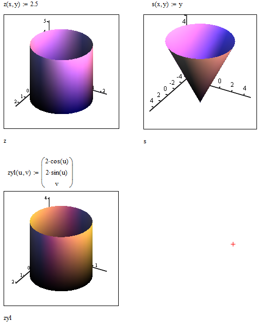

Hello...
All I'm trying to do is plot a plaine, old cylinder in MC 15 in 3D. There is nothing about it, and what I have found anywhere, including PTC is not explained, discussed or elaborated upon.
Can SOMEONE tell me how in the world to plot a 3D cylinder in Mathcad 15 please.
Thank you
Best answer by Werner_E
There may not be explicitely a cylinder shown there but the built in help and tutorial shows you how to plot a parametric surface, a parabolic cylinder and surfaces of revolution, which should help get you starting.
Searching this forum brings up a few links which might be of interest to you:
http://communities.ptc.com/message/202454#202454
http://communities.ptc.com/message/165035#165035
http://communities.ptc.com/message/73592#73592
The easiest way to plot a circular cylinder sure is to use Mathcads feature to use cylindrical coordinates instead of cartesian. Next easier is the use of a simple parametric represenration - both shown in the attached file. You may also use CreateMesh, plot a matrix or do it by other means. It all depends upon your needs.
