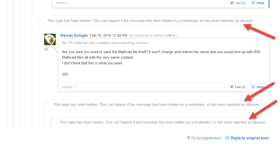

February 10, 2016
Not sure whats going on here.
All I see is:
February 10, 2016
i was thinking i can save the calculation with the values for the Calculation?
example:
after saving step i have the result for the variable. I can place the formula after the result and i have a calculation for every load stepexample
3 = Fxp
Condition
Fxp < Fzul x pzul    Conition: true
just placing the Formula how i calculated the result value as example.
February 10, 2016
Hmm jea i need for further analysis and reporting The Mathcad File with the inserted values for i because i need to do a documentation and for that i can insert a picture with the Formula so that i have a Calculating Report for every Loadcase. And For that i need the real values wich leads to the result and Parameters.
Coz of the needed Calculationreport for every Loadcase. Hmm
Hmm but thx for the help so far. Maybe you know if there is a possibility or a command in mathcad to perform a saving process.
Hmm should i open a new Question regarding saving process while performing a Loop ?
Yea The Name of the saved file should be The column with the load Case for example Load Case 1, insert i=1, and save the File with the Name "1" or whatever there is standing in the column.
Important is the Value for the Result as number for every loadcase
