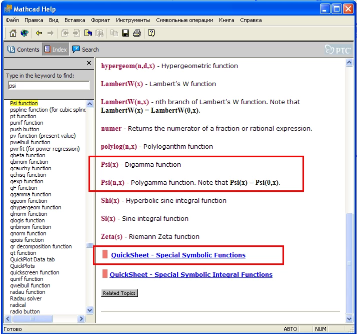

The Psi function only takes one parameter; try just Psi(y).
Stuart

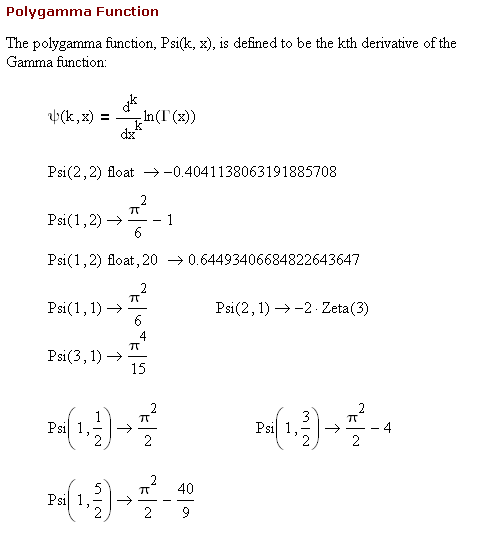

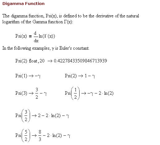

The digamma function, Psi(x), is defined to be the derivative of the natural logarithm of the Gamma function Γ(x).
The polygamma function, Psi(k, x), is defined to be the kth derivative of the Gamma function.

Mathcad has two processors: one for symbolic math, and one for numeric math. The Psi function is only defined for symbolic math. That's easily remedied though.
